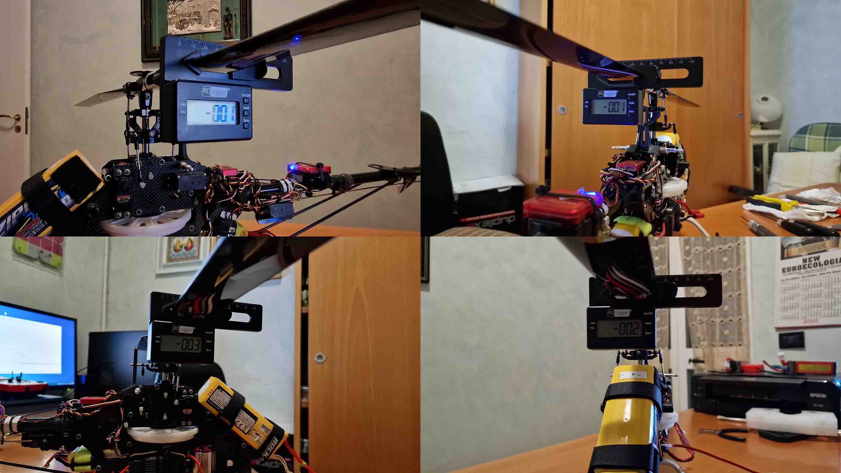

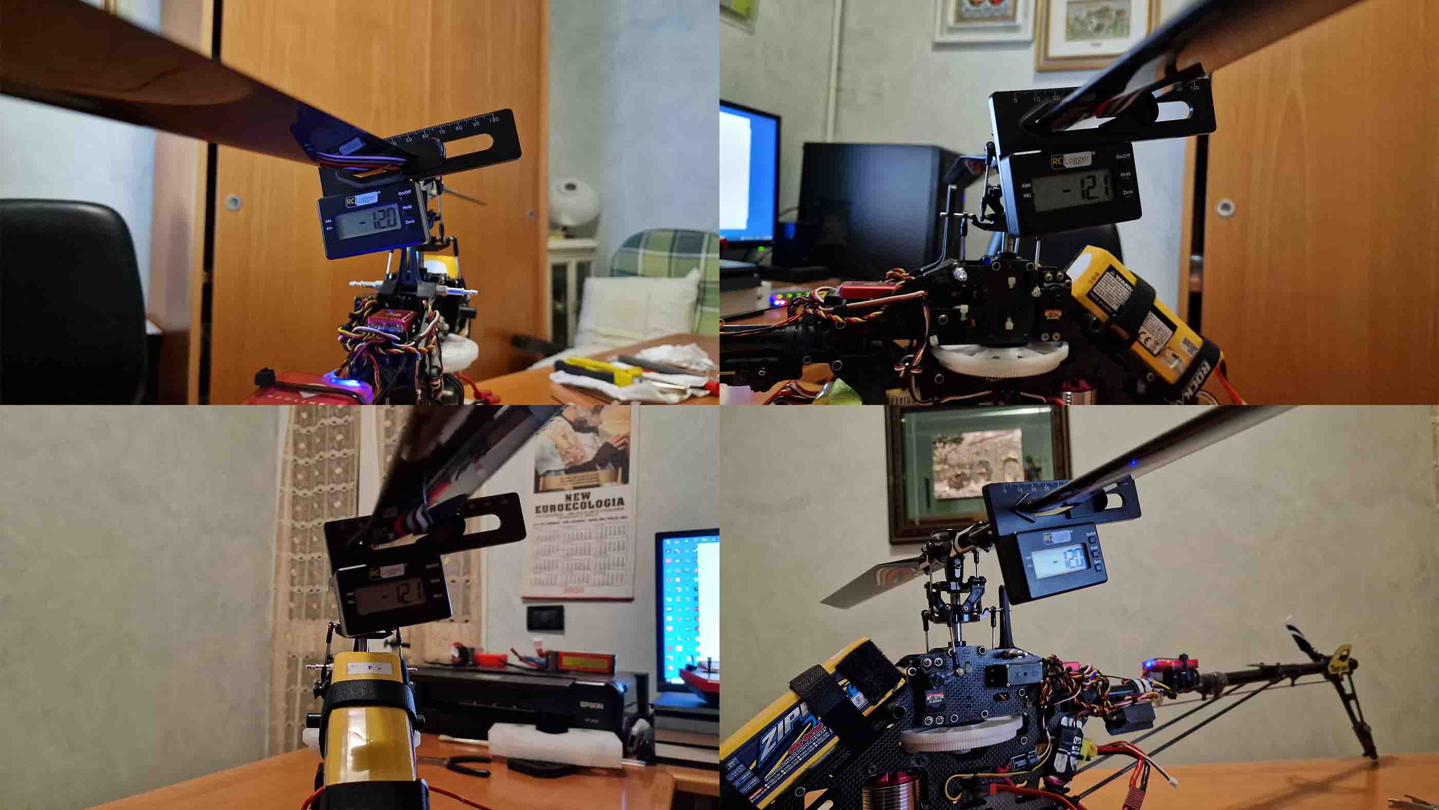

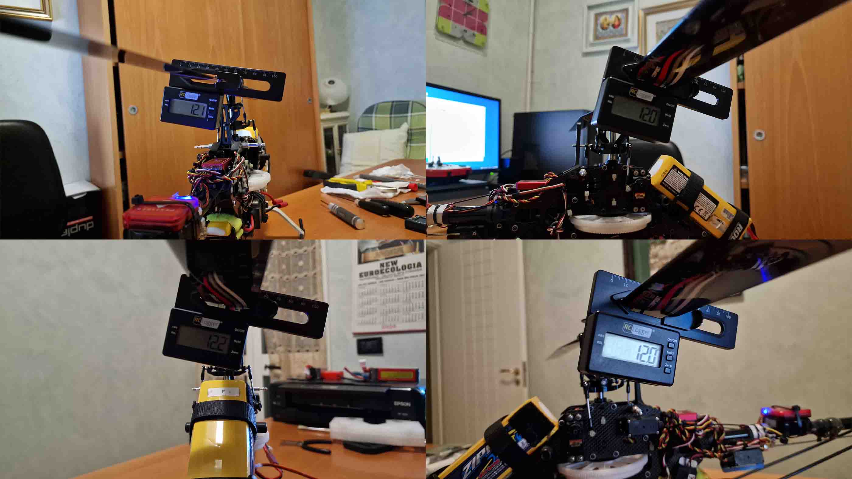

ok ZeXx86 now I fixed my head.
Now i have 0 degrees at center stick in all 4 blade positions.
12 degrees at maximum sticks in all 4 blade positions.
-12 degrees at minimum sticks in all 4 blade positions.

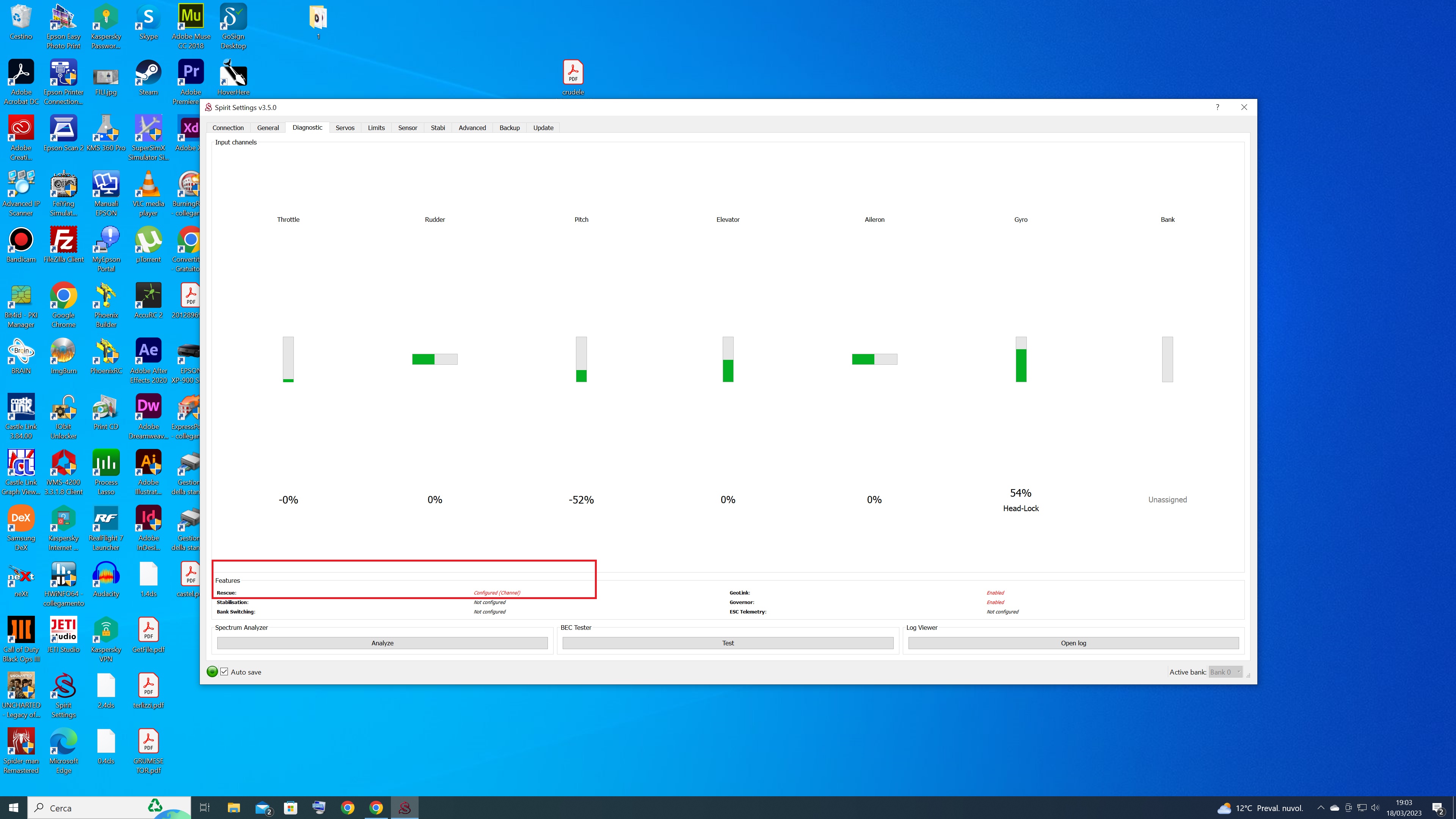

after checking the settings and log I can see two important problems.
First is - your settings has Collective Pitch reverse - this is required only for models that have some kind of mixing which mean that when swashplate goes up then resulting collective pitch is negative. When it is down, then it is positive.
In all other models it must be not enabled otherwise functions such as Rescue, Stabilisation, all GeoLink functions will fail sooner or later.
Because your model require this settings it also mean that other base settings must be wrong. Unfortunately this mean that even servo wiring could be wrong, including servo reversing.
This is thing that must be resolved as soon as possible, because all FBL functions will work very poorly and incorrectly, even if it does seem it fly well.
Next important thing is to resolve extremely high vibrations. Your model is reaching nearly 120% all the time which is order higher than model should be normally.
This could have impact on Rescue/Stabilisation and all GeoLink functions as well. With other FBL units it is very probable it would crash immediately after lift off, because it will confuse the sensor. So please make sure to fix it to be at least at level around 50%. Your model can easily fly with 15% if all will be fine.
This is important also for good safety, because even secured bolts can unscrew.
