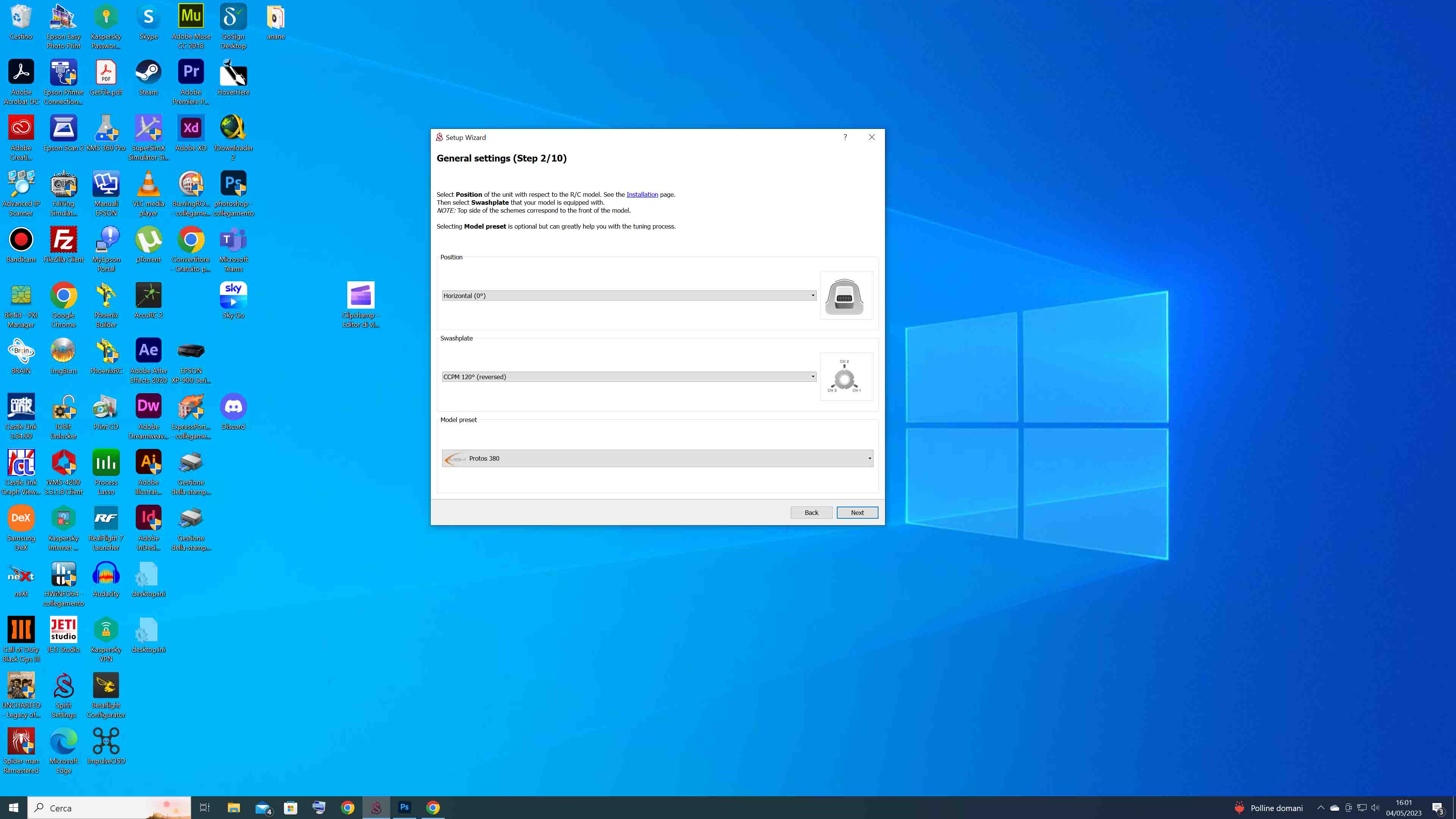

But I want to say one thing that I have seen from the beginning.
in the software if you choose the preset of trex 500 goes out swashplate 120° but the trex 500 it has an elevator towards the tail Therefore this model he's called 120° reversed.
Another example
if i select protos 380 goes out 120° reversed and elevator protos 380 it is located on the nose then it is called 120°
Why in the software spirit the name reversed it is used in reverse ?

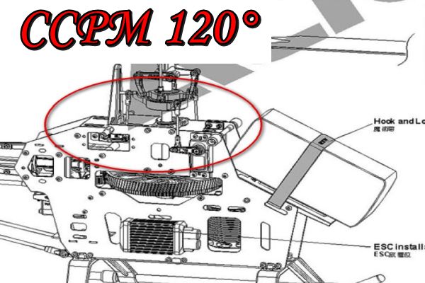

You are right, that Trex 500 has elevator servo at the rear. And for this reason it must be configured for "CCPM 120°". Not Reversed.but the trex 500 it has an elevator towards the tail Therefore this model he's called 120° reversed.
So preset is correct. I dont understand what is wrong from your description.

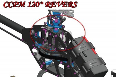

I dont understand why CCPM 120 reversed should be changed?
It only mean that it is reversed by 180° from CCPM 120° - from previous option.
There is no relation to elevator servo in word "Reversed". Reversed mean just Other orientation.
I am the boss and also developer. So everything I find as wrong will be fixed. But this name is not to be fixed. It is in this way for around 12 Years and will remain like this.
Bigger portion of models have CCPM 120° option. For this reason it will be configured more often. And for this reason CCPM 120° (Reversed) is as second option.

ok i tried to avoid saying that till the end because it didn't seem right show itHabásek wrote:to franz88:
Software Spirit is OK.
Manuals Trex500 and Protos380 is OK. (photo:)
Look for an experienced rc heli modeler in your area and solve the vibrations and settings first.
I set up other flybarless and in other flybarless they use another system Now I don't know which one is right given the misunderstanding
