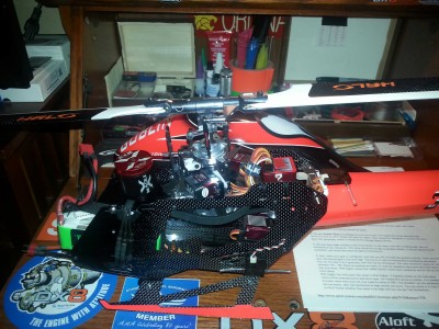

My rx is two dsmx sats at the same locations the manual suggests. One on the boom and the other on the left side of the frame. Both are at 90 degrees to each other.
Picture shows sat placement but is a lil dated. Everything is still routed the same but the rpm sensor from the hw esc is now plugged in to the correct port.
