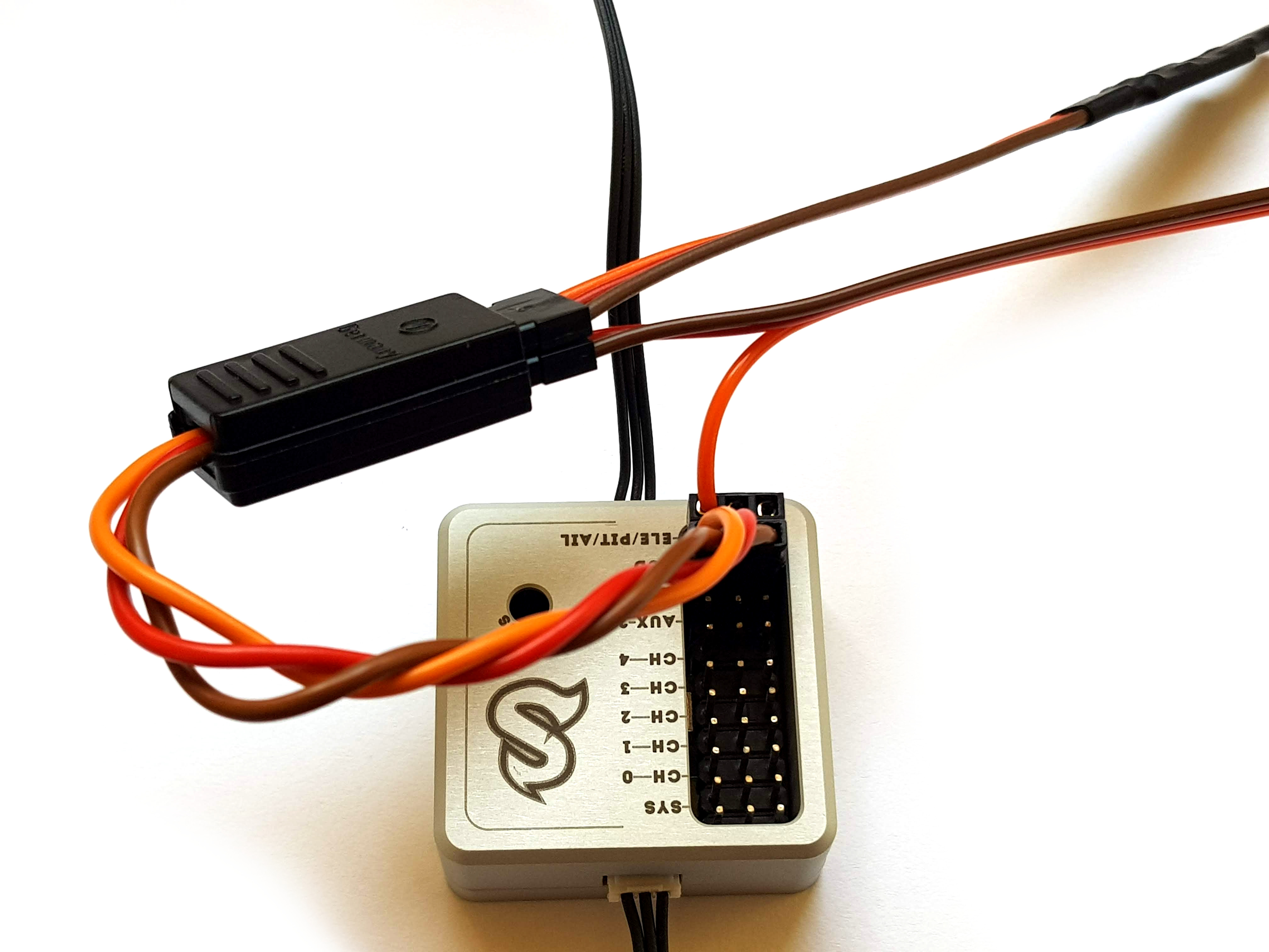

Posts: 12836
Here is how you can connect 3x Spektrum satellites and 1x SPM4649T together with Spirit Pro.
You can also connect 4th Spektrum satellite instead of SPM4649T - it is only necessary to modify Spektrum adapter so that signal wire is separately connected at the AIL pin.
