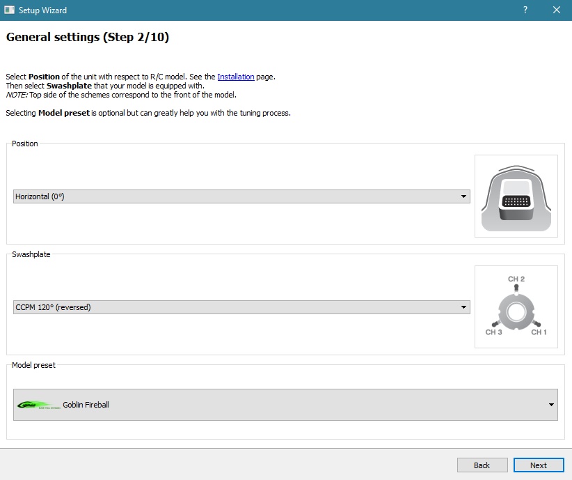

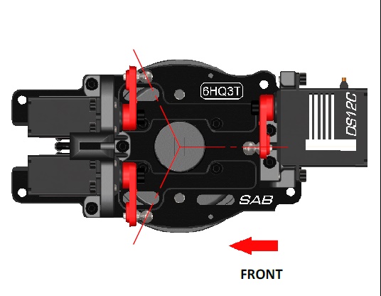

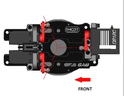

I have an question - I think the direction of the swashplate (inverse 120 °) in the setup wizard is not right. The correct direction has to be 120° because look at the attched files -
Am I right ?
Best wishes
Matthias
Attach: The attached files are hardcopys out of spirit setup wizzard an sab fireball manual
Posts: 13051
you are right that for this helicopter CCPM 120 is the right setting.
If you will re-download the Spirit Settings it will be all fine :)
Regarding Throttle indicator it seems that your throttle value is way too low when Throttle Hold is engaged. It should be closer to 0%. Then it will be fine.
