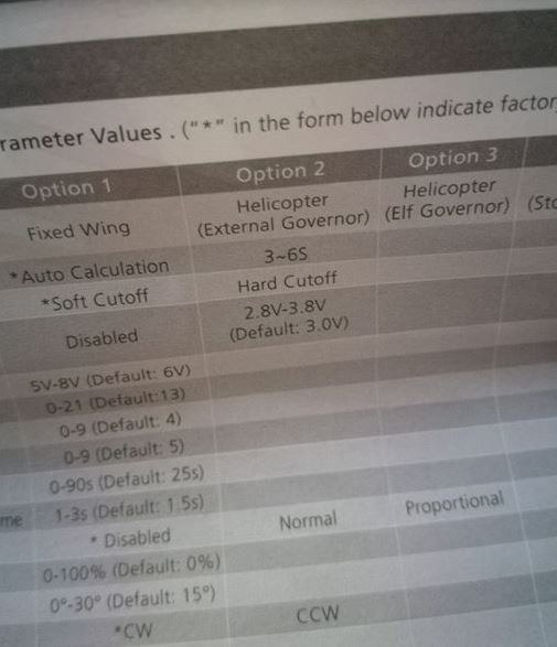

Hi Urgno, thanks for your reply.
So if I use the governor in the fbl unit I should choose option 2 in the photo?(manual esc hv)?
Viceversa, if I use the esc one, don't I have to use the spirit one?
But what are the differences in using one or the other?which benefits? advantages and disadvantages?
Posts: 13054
Yes, you are right.
For the most pilots internal Governor is more than enough. For more experienced pilots or these that are not satisfied with ESC Governor you can use Spirit Governor which has more data from pilot and model so performance can be better.
