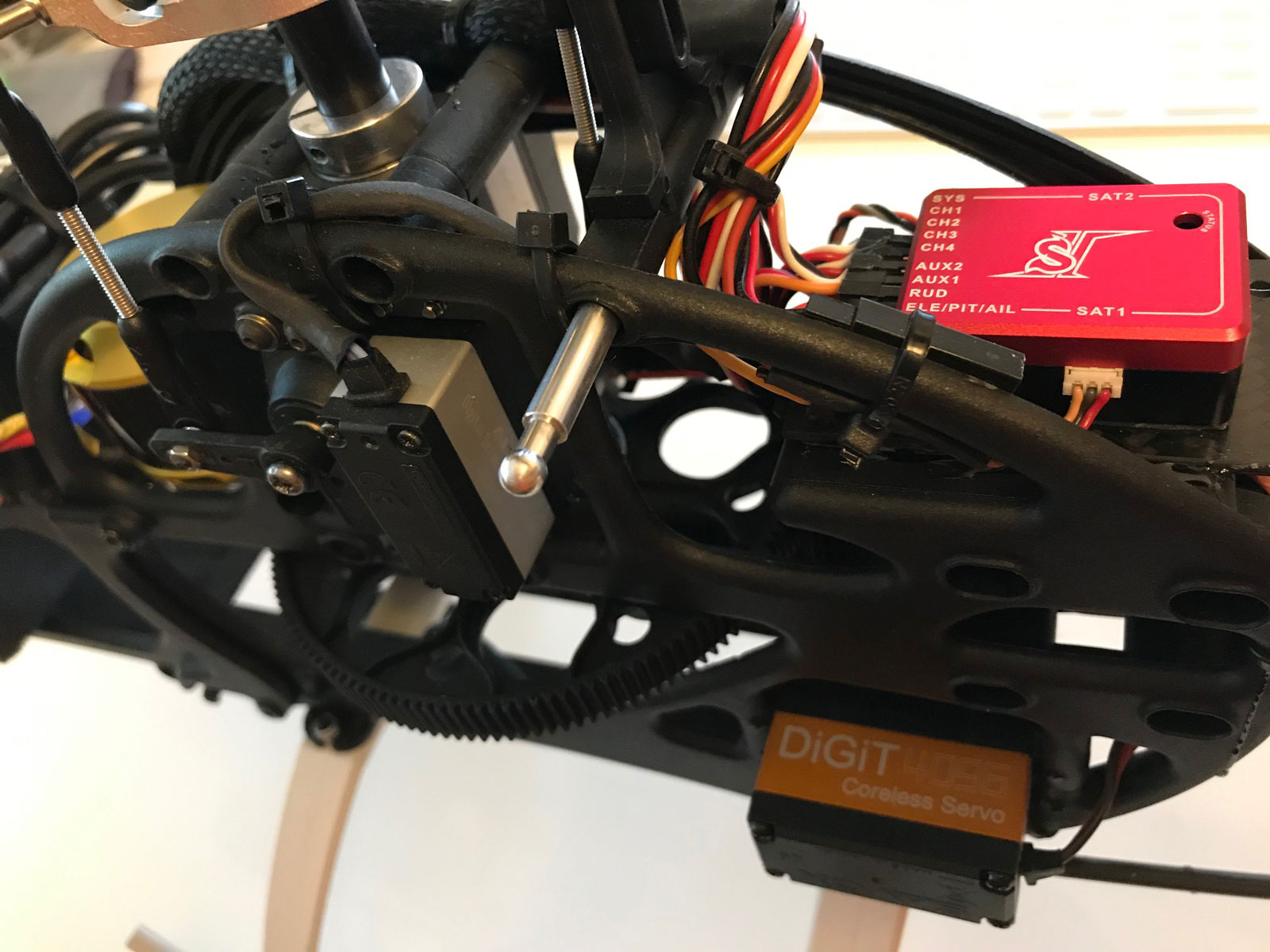

Posts: 13059
could you please send photo of the unit - so I can see how it is mounted and also to attach your settings here?
That would be very helpful. Vibration shouldn't be a problem.

Hello Tomas,
thx a lot for your kind support... pls find attached the files you asked for. and i added a log of the flight...
the plattform where the Spirit 2 is mounted is '99%' aligned with main shaft, the Spirit is 'perfectly' aligned - one layer of supplied tape to mount it.
(spm4649t is attached on ele/pit/tail + rud as per specs. Hw 80 telemetry on sat1 and additional dsmx sat on sat2.)
best regards
Michael
