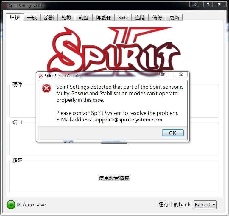

Update status when I try to flash my uSpirit Back to 3.0.
In setup wizard it shows my unit is Spirt, but actually it's uSpirit.
An I got an error message here.
Posts: 13059
the problem was not update, but something happened to the internal data of your unit.
It can be fixed easily. We will send you firmware that can fix your unit. Then it will work again with any version.
