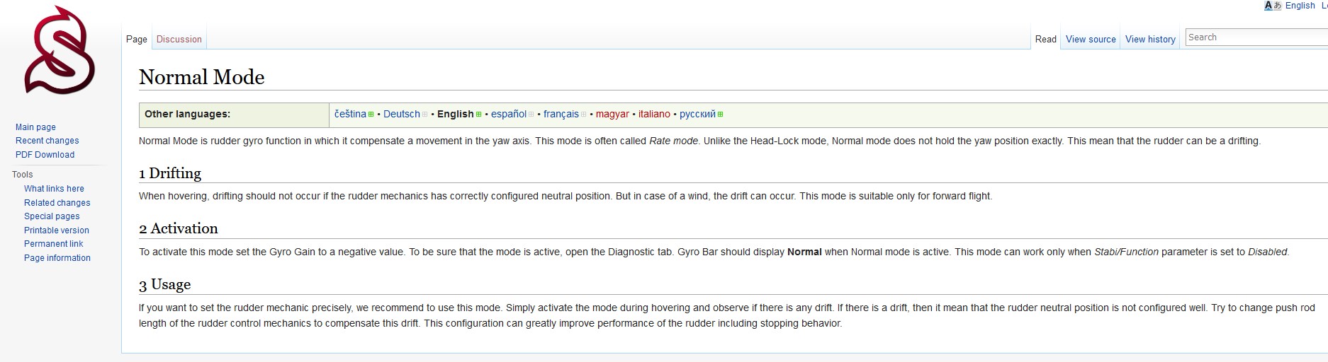

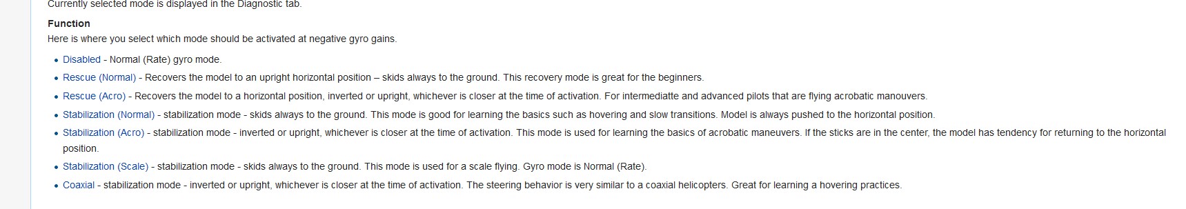

Hello !
The question is solved !
You can find the hint in the manual by clicking on Disabled - By looking a second time to the maual I clicked on it and the fully explanation was popping up - If anybody has the same question as me see the attachment -
