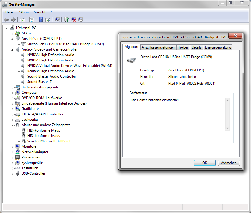

Unfortunately I can not make connection to the PC, because it recognizes my USB connection as a virtual ballpoint. because after my mouse jumps wildly and sounds on the way everything possible to. Attached is of course everything right. Have already googled a bit, but not really what useful found. Apparently, it must be on the driver. Silicon Labs USB to UART Bridge CP210 driver he shows me in the device manager. lists it to me in the hardware list but as mouse :(.

Posts: 13008
most probably problem is just in COM ID.
Can you send me a screenshot from your Device manager?
You can open COM & LPT and there should be the Silabs Device with some COM.
If you can, open properties and set COM port to the lowest possible.
Then unplug and plug the usb interface again and open the software.
You should see the device with configured COM port in list of available devices in the software.
Then all should work without any issue.
Actually this is not a bug, it is Windows feature that it assigning too high COM ports that are not valid. This can happen in case you are using more similar devices. For example Castle Creations USB link, MSH Brain, etc. But then all will be working fine.

ok here.
explanation step by step pls: D
Thank you for the help
Posts: 13008
Great,
try to change COM9 to for example COM1 or the lowest possible value.

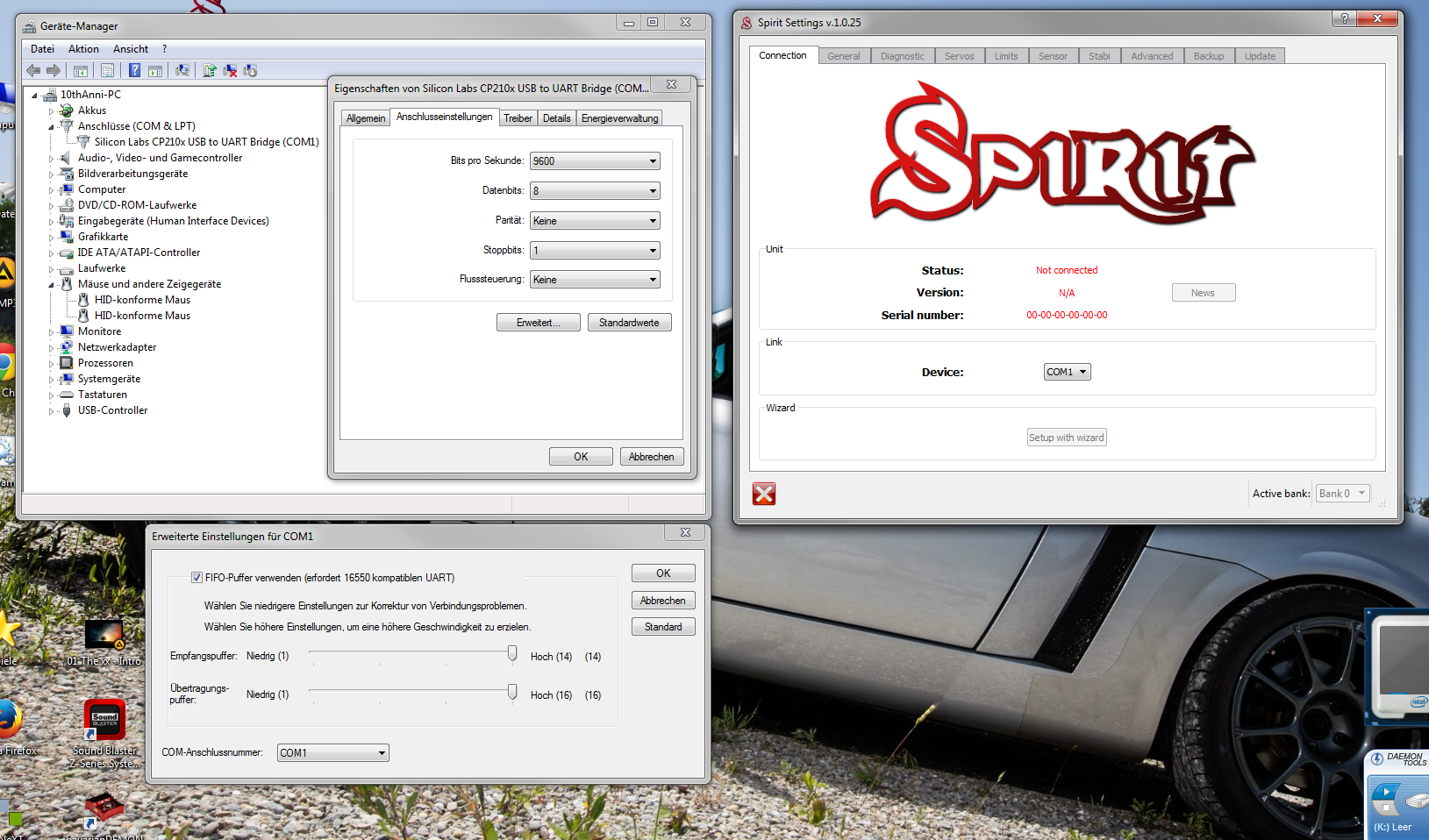

That with the mouse is gone now.
However, I get no connection materialize.

When I rebooted the pc today, I again had the problem with the mouse. Com port 1 is set.
a connection to the spirit and I do not get out :(
