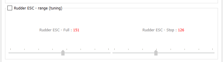

I fail to understand how this tab should be setup Rudder ESC - range (tunning)
What I do:
1. Existing values from the manual
1. I tick the checkbox
2. motor starts idle at low speed
3. once I click any slider motor starts spinning at full speed.
4. at this point already have less than 5 seconds to act since this can burn the motor/esc
5. I quickly move the left side slider to get any feedback from the motor
6. from multiple tries I figured out that motor stops at ~200 value.
7. any other value does no change - motor spins at full speed
Can I get some hints if this works correctly or do I miss some steps?

the process seems to be good.
At step 7. you should start from the lowest value. If it will still spin up quickly, then please set the lowest value.
