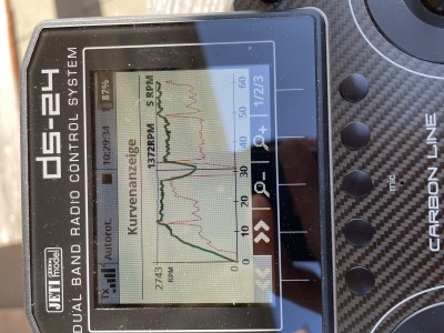

I had about 10 flight (just hoverings, because of beginner :-)) with the mentioned setup and no problems. Still with the "RPM sensor data are to noisy" in the log, but no abnormalities.

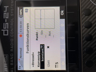

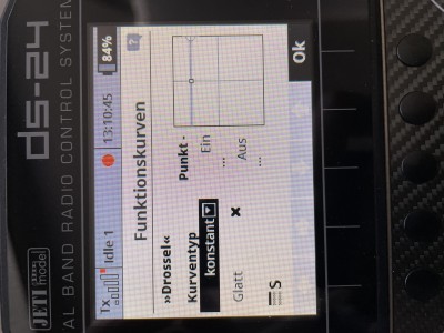

Yesterday i changed my RPMs for the first time from 2200 to about 2500 (through flight mode, Normal to Idle1) took off and suddenly had a RPM collapse to 1370 RPM, as you can see in the Jeti Log.
"RPM sensor data are to noisy" was the only entry in the spirit log, I change the RPM through flight modes (Heli Setup) an constant curve:

can you replicate the behavior each time? I recommend to remove main blades and try again at the bench.
Can you share settings file from the unit please?
Noisy RPM could be only due to very high governor gain values - for example Governor Response.
Isnt there some other throttle curve? I guess the problem with RPM is due to programmed Throttle Range is out of range ESC know.
But first I recommend to replicate the behavior on the bench which will be with no risk.

No there is no other throttle curve, only these 2
