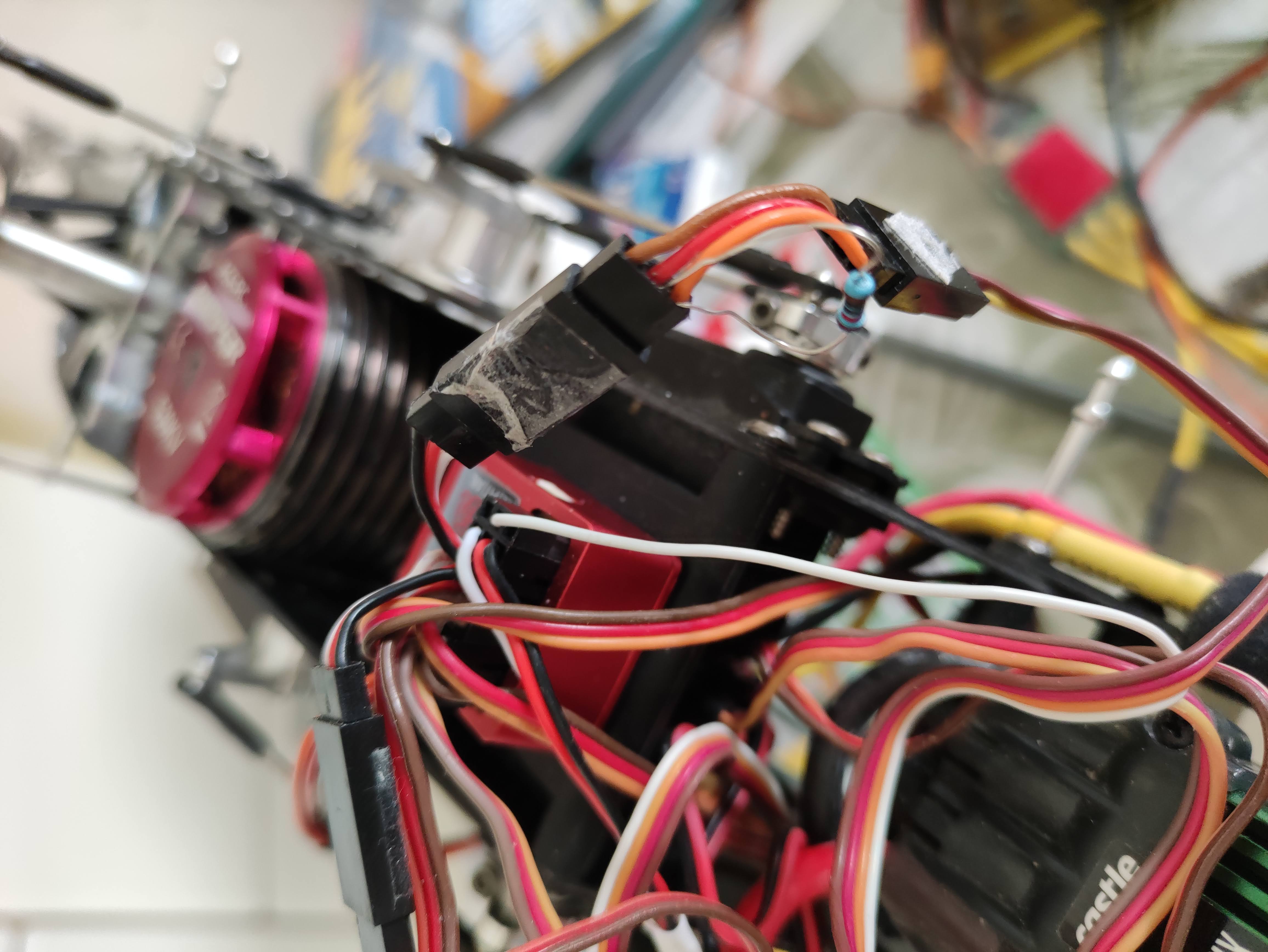

The problem did not leave me in peace and so I was there again this afternoon. Since I still couldn't do it after trying the cable several times, I tinkered the cable myself with a resistor. Lo and behold, with my own cable it works straight away.
So unfortunately the original cable is defective.

yes, we have checked the cable and we can't find anything wrong unfortunately. It worked immediately with our testing model.
The only difference in the cable is very slightly increased value of resistor, which is approximately 10,1 kOhm, instead of 9,9 kOhm that is on the most other Telem CC cables.
But this is all in tolerance.
So unfortunately we have not found anything wrong, except the cable was bent significantly. At least from what we were able to find.
So the only thing we can do is to ship new.
