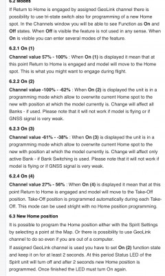

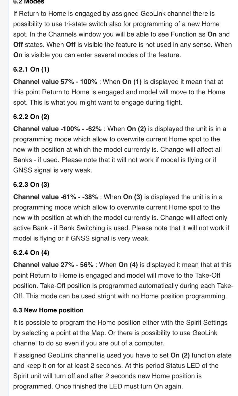

It is better to switch it off.
Or even better you can use 4th mode of the Return to Home feature.
Then no programming is needed at all. Mode will return to lift off position in this case.

4Th? how do i set this? i haven't seen

Ok ... i found it
