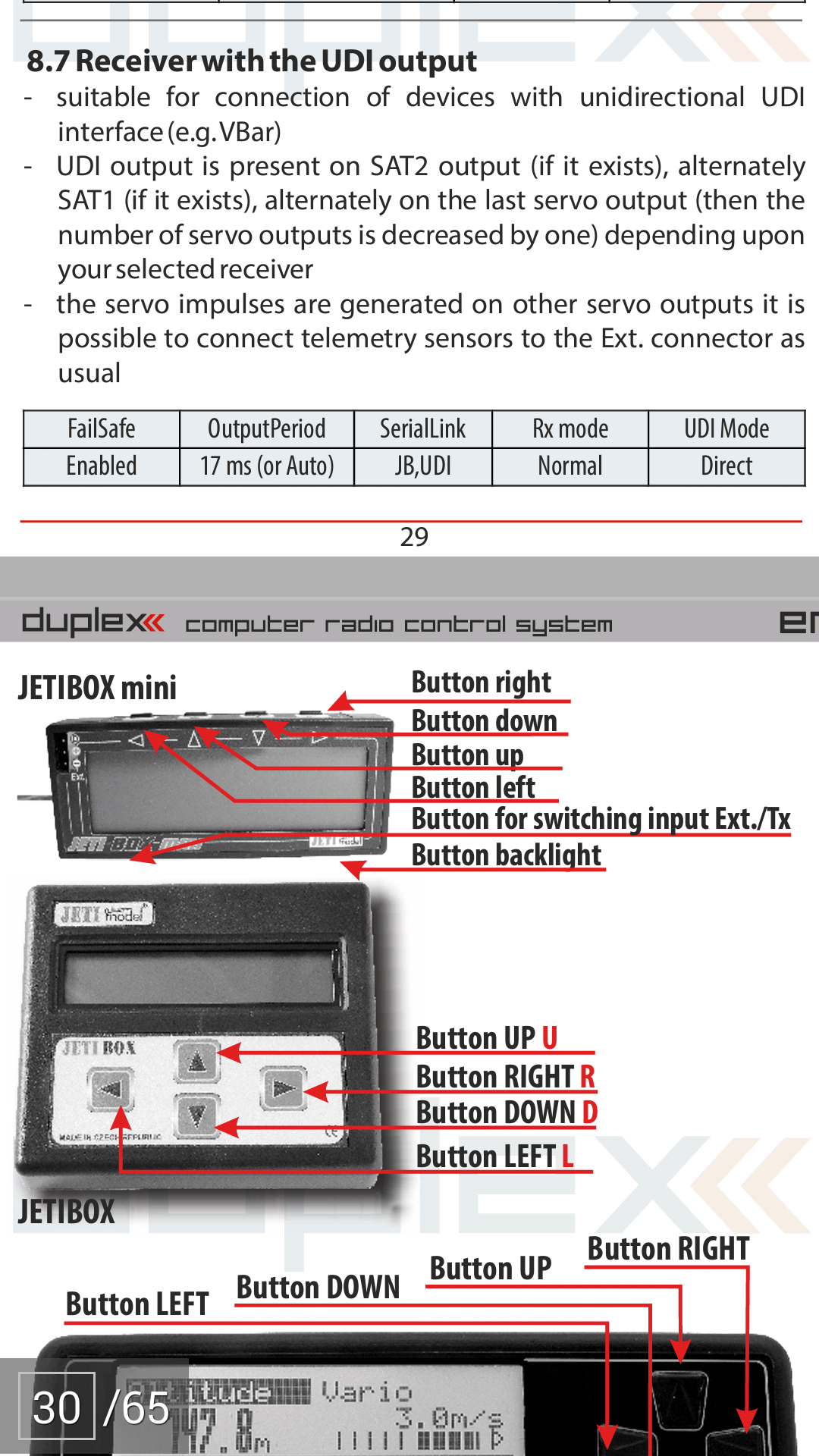

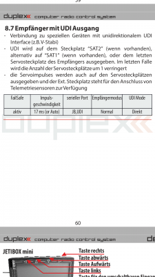

you can connect the receiver in few ways - PWM, PPM, UDI or EX Bus.
Which one do you want?
For UDI you can use SAT port, for EX Bus EXT port. Be sure your receiver is updated else EX Bus will not work probably.
For UDI you have to select SRXL/SUMD receiver type.

For me R9 EX is working out of the box.
Only you have to do is to configure UDI serial connection in your receiver. Then you should see it is running on SAT port.
And finally configure SRXL/SUMD receiver type and save the settings.
Then, after restart all should work.
