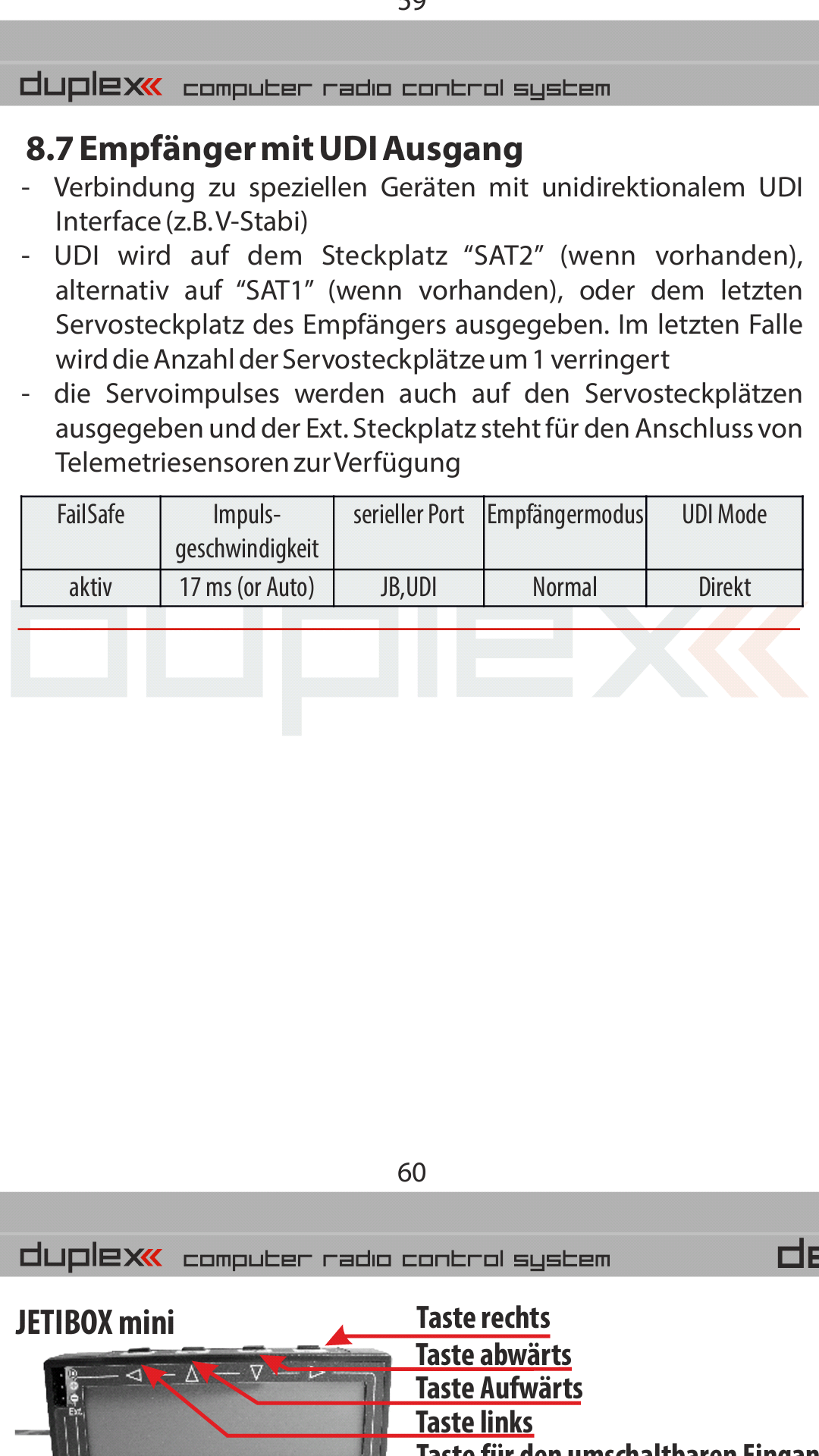

For me R9 EX is working out of the box.
Only you have to do is to configure UDI serial connection in your receiver. Then you should see it is running on SAT port.
And finally configure SRXL/SUMD receiver type and save the settings.
Then, after restart all should work.
