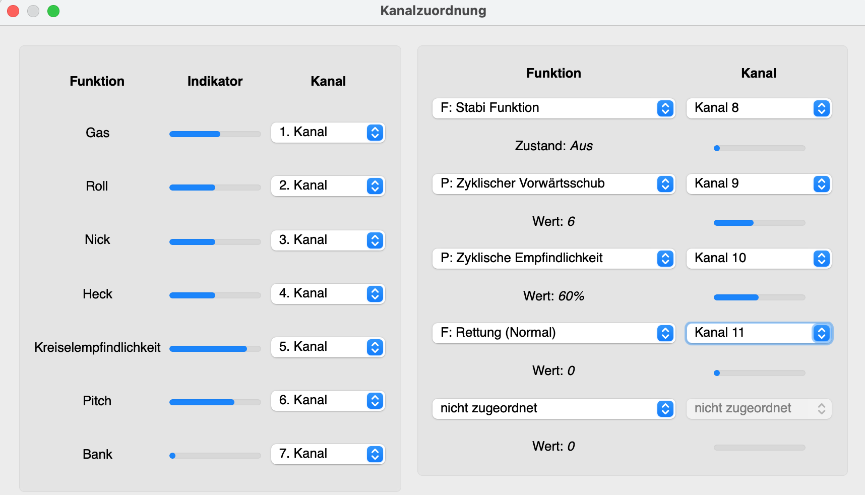

i guess i do need some help with setting up the new rescue engaging options - i do not get it to run :oops:

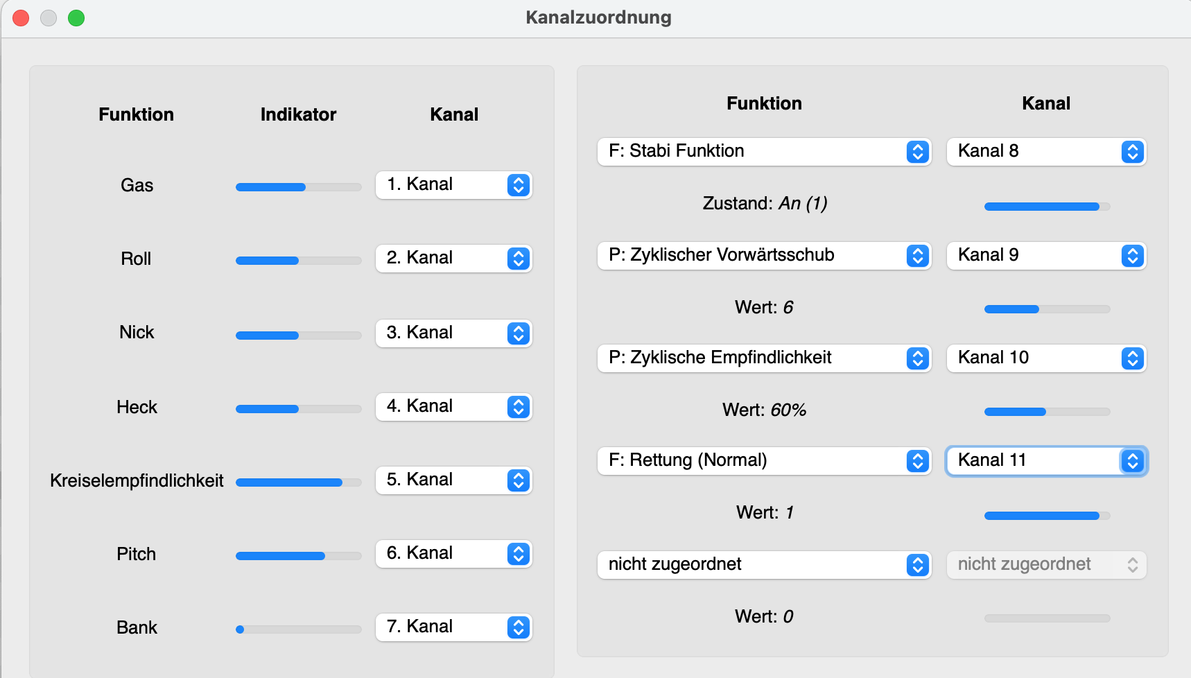

what i've done: i have mapped additional channel #11 from a new switch to F:Rescue (normal) function (see screenshot). both, the old (ch#8) and new (ch#11) switch are working (see screenshot 2) independently.

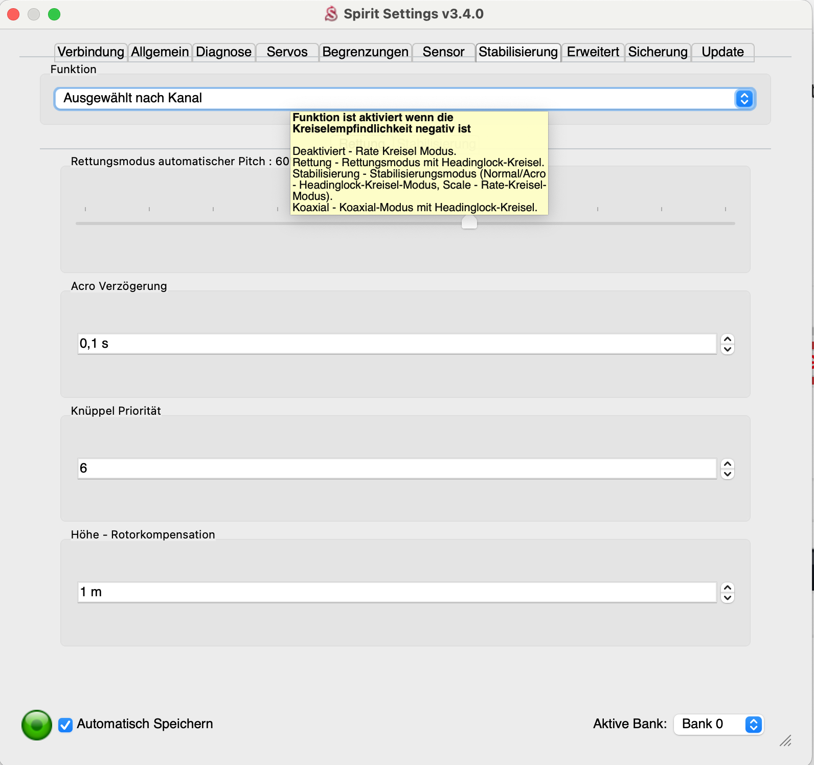

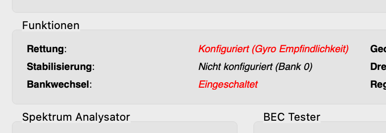

at this moment the old switch (ch#8) was still working and starting rescue normal as setup in stabi tab. then i changed stabi/function to "select by channel" and the new switch (ch#11) did not work - no reaction at all. after this config change in Diagnostics tab it tells me: "Rescue: configured (Gyro channel)". see screenshot.

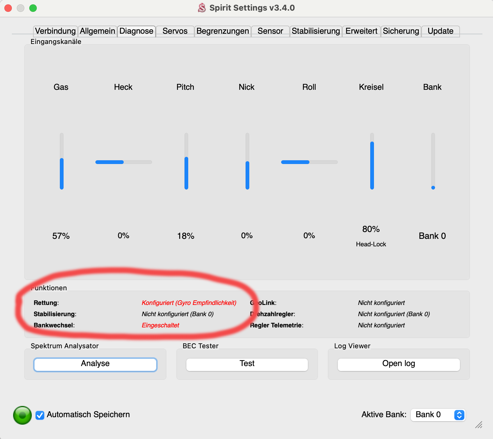

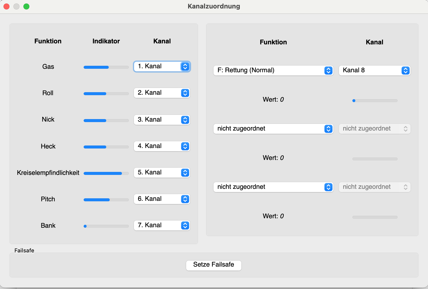

1. another factory reset of Spirit RS, ch #7 set to bank switch, ch #8 set to F: Rescue. nothing else setup.
2. Stabi / Function set to "select by channel" (all banks identical) => does not work.
and again: Diagnostics screen showing Rescue: activated (Gyro gain)... see screenshot.
screenshots attached, settings file attached....
