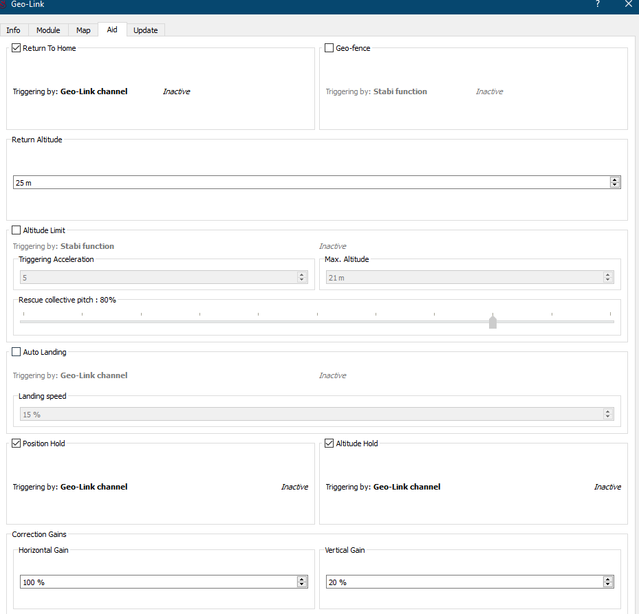

My position hold doesn't seem to work.
XY position holds steady, but the heli moves up down, getting more violent and bigger jumps as time passes.
My vertical gain is set to 10%.
Is it safe to just keep reducing this value to zero?

Just put the heli on the bench to update to 3.4.1 (thank you so much for RTH at a known altitude!!!!).
My vertical gain is actually set to 20%, and I cannot reduce it any further. The heli is bouncing up and down when pos + alt hold is enabled.
How can I fix this?

Attached is my settings file for my Align 500x that oscillates when pos+alt hold is engaged.
500x.4ds
(255 Bytes) Downloaded 113 times
