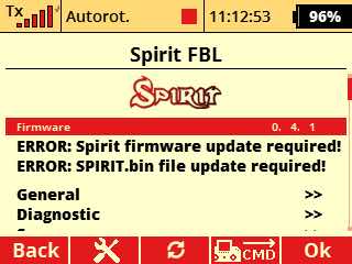

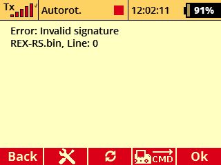

I have a problem that I have not been able to clear. First time Spirit user needs help please.
Jeti shows Error:invalid signature for device REX-RS, and does not show correct version on firmware in integration with errors. New Spirit GTR, first set up, never flown. These errors occurred immediately.
Jeti is DS-16 G2 - fully updated.
I have now updated GTR to v 3.4.1. I have loaded latest Spirit.bin and REX-RS.bin files (downloaded today) to Devices on Jeti. The errors are still present. All screenshots below.
(As shown in Devices folder on Jeti - Spirit.bin file 26-May-2022, REX-RS.bin file 23-Sep-2021)
How do I fix this please? Any help is very greatly appreciated. Thank you.

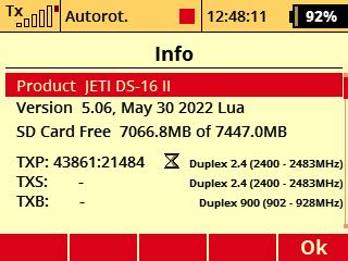

Can you let me know what firmware version is installed in the radio?
It seems also that REX-RS.bin file is missing in the Devices directory.
Updating radio could help.

Thanks for your quick reply.
Jeti version 5.06
Jeti version.jpg (20.46 KiB) Viewed 3858 times
REX-RS.bin is present. Sorry I cut it off in the previous screenshot.

Re: Jeti - firmware version displayed incorrectly - errors
Posted: Tue 05. Jul 2022 14:10:43
by Habásek
Spirit.bin from May 2022 is old in your tx and also Rex_RS.bin from 2021 is very old.
https://www.youtube.com/watch?v=ZBwKQNtHfGs
https://spirit-system.com/dl/jeti/SPIRIT-3-4.zip
Posted: Tue 05. Jul 2022 19:55:35
by Alistair
Hi Habasek, thanks for your reply. I thought that might be a problem. But I download the zip file from the website only 3 days ago. The files on my TX are the newly downloaded files.
I just checked again today in case it changed after the release of 3.4.1. No change. It is still the same files I have loaded on my TX.
Best regards, Alistair
Posted: Tue 05. Jul 2022 20:45:05
by ZeXx86
The files you have are recent. They are really from May for version 3.4.0. There is no 3.4.1 yet.
For me it look like there is some problem with communication between unit and receiver. I never saw the issue earlier.
Maybe you are using some special configuration for the receiver?
