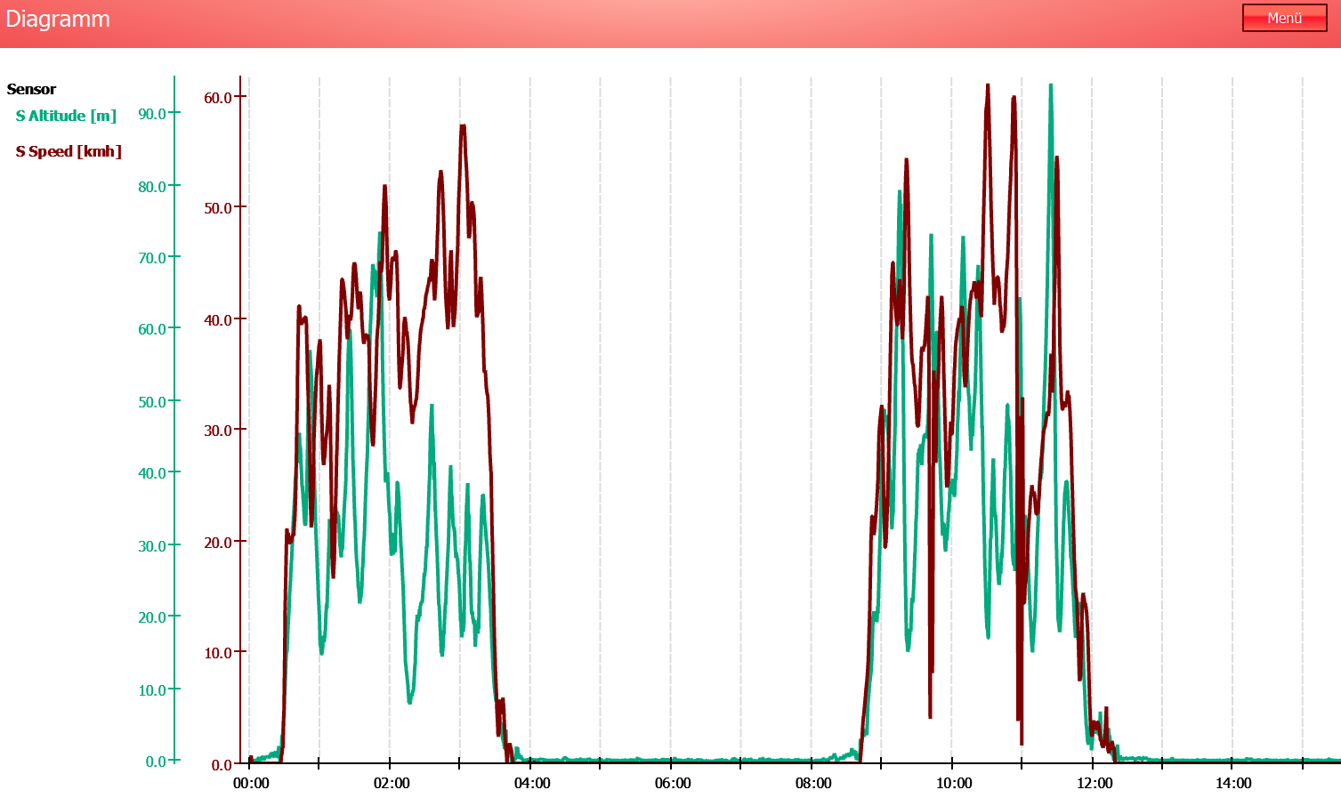

sacha
Posts: 34
Joined: Thu 14. Apr 2016 18:43:40
Hello Tomas
I'm also using the Geolink V2. I used one on a TDR without any problem. It recoreded speed until the end of the flight.
See the graph.
If you need another tester, please let me know.
Sacha
