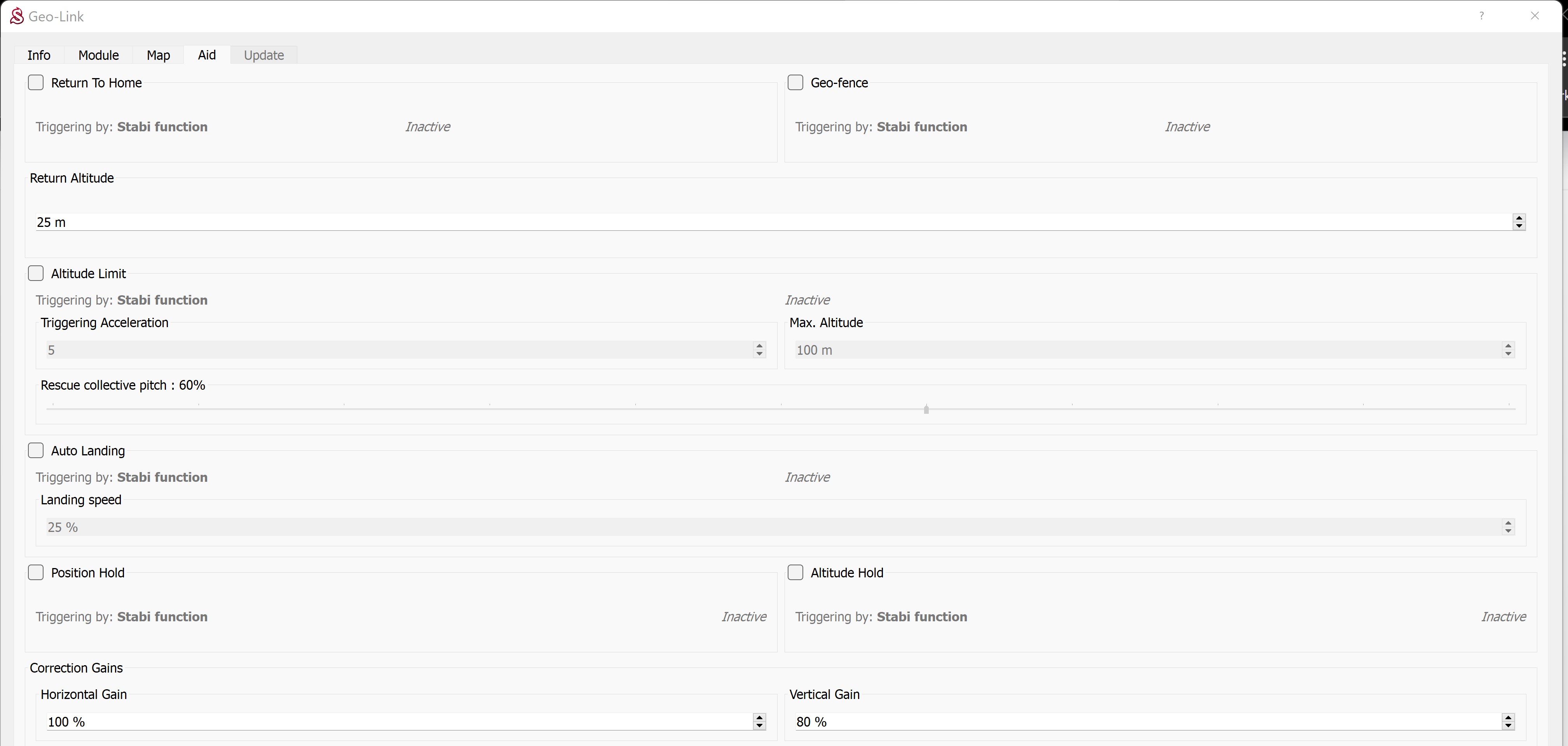

I am in the process of installing Geolink 2 with my Spirit Pro. Using Sprit 3.4.1. In the General/Geolink/Aid windows, only maximum altitude is available to be configured. No minimum altitude, which is the setting I need to set for enable a hard deck. See attached screen shot. Appreciate any assitance!

... and I am in Bank0

Hi larspe,
The setting for minimum altitude for Hard Deck will (according to Tomas) probably return due to requests in one of the following Firmware Updates - the way it is right now is actally how its meant to be - you assign a channel to F:rescue(Auto) and the height at which you engage the function is Set as Hard Deck Altitude. ImO a very elegant and practicable solution...

Well - not so fast :-( Rescue (auto) is not available for the Spirit Pro, only GT/GTR. How do I configure so that hard deck is activated (and deactivated)? Thanks!

Oops, musst have overread what Version youre using -
Rescue (Auto) /Hard Deck from the fbl ubit is only supported by gt/gtr since its the first Revision with a built in pressure sensor (=altimeter).
So you can "only" use the geolink function for this (probably wont notice any difference to the pressure sensor Hard Deck..)
See configuration/altitude Limit in the geolink Manual (http://manual.spirit-system.com/index.p ... tude_Limit)
Sorry to Not being of more help, but i havent used a spirit pro so far, only spirit 2 and gt - spirit developer Tomas (Zexx86) will probably have to step in and answer, hes sick this week (See "limited Support" thread in the Support forum, hell surely answer next week :)

The minimum height will be set at the height where you first engage geolink hard deck.
