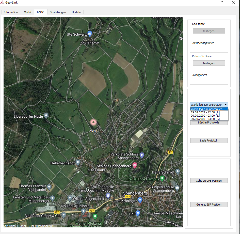

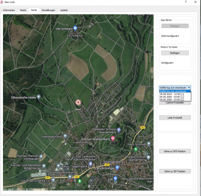

1.When i like to look in the Geolink log´s the first log is most possible to look.
The next flights are set with timestamp 0 and not choosable.

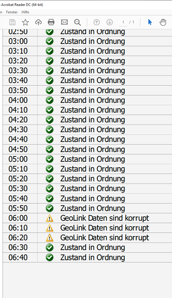

A fault that the geolink data are corrupted is shown in the log viewer.

- spirit-log-2022-08-29-134206.pdf
- Here is where the Geolink quitts
- (60.67 KiB) Downloaded 87 times

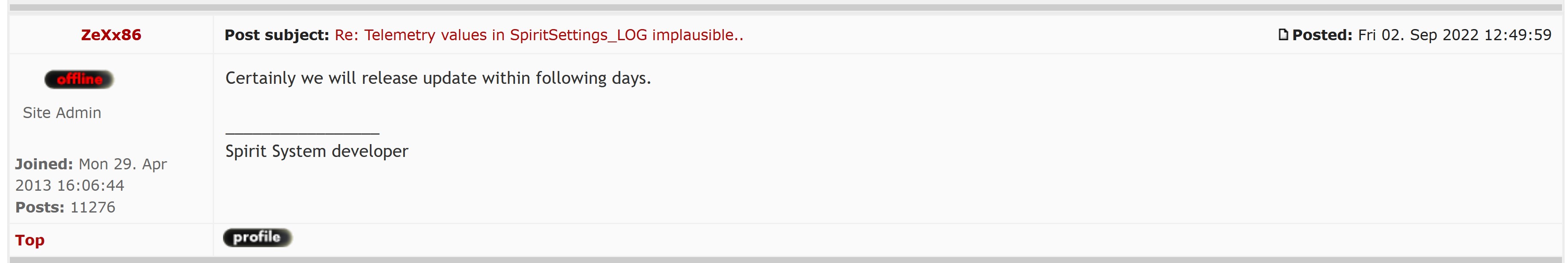

Hello Herve,
I think we have all the same problems (notround, mattes61 and you) Tomas said that there will be an update to fix the problem in some days

When i look in the Geolink log´s there is only one log after two flights.
At the first try to download the log the connection with the geolink get lost and error thrown "data corrupt".
After reconnect power the download is possible.

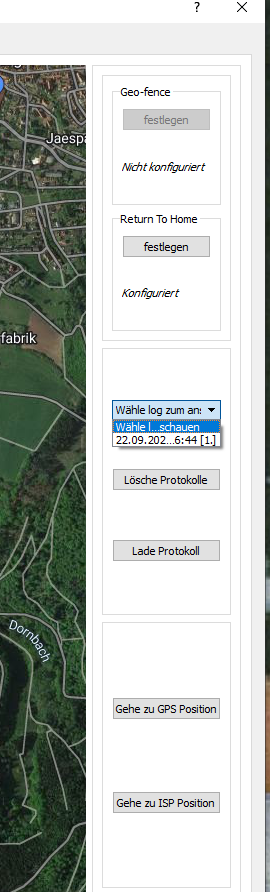

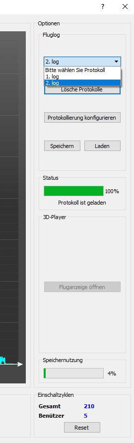

if your model is producing too much electrostatic discharges the GeoLink itself could restart, because it is sending too high voltage there. This is indicated by Green led light after landing.
If this will happen GeoLink log might not show for the present flight immediately. But it is fixed automatically when next log is added.
You can check if after more flights the missing log will show. Although high voltage spikes are relatively dangerous for whole electronics on the model we will try to make it seemless even if logging is interrupted in next updates.
For now it is enough to do more flights and the logs are fixed automatically.
