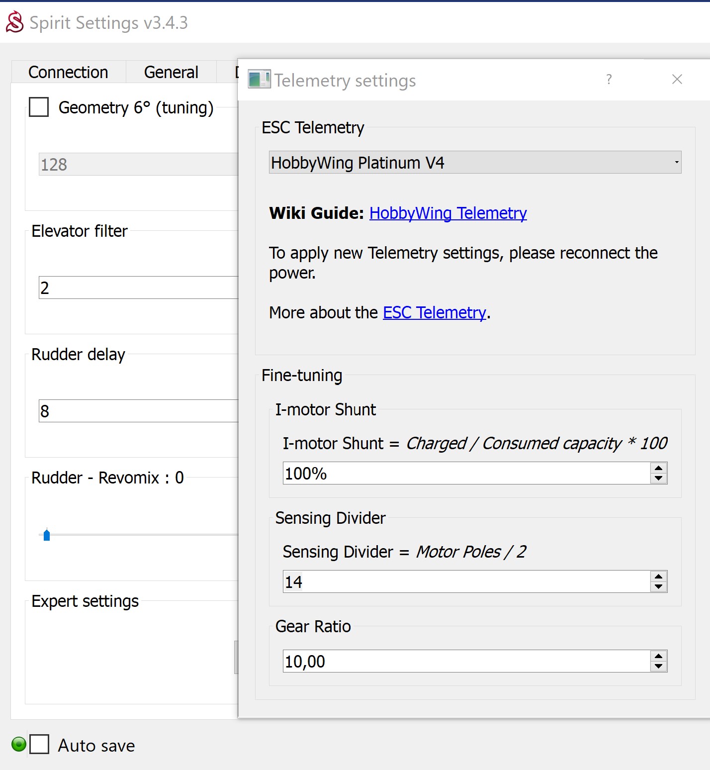

I am using telemetry with a YGE 65 on a Spirit GT what do I configure for the « sensing divider » ?
Got the latest version but number can’t be 21, in the spirit menu it says divide number of poles by 2 and I think it is max 12 that the menu accepts.
Here is the motor specification :
* Motor Setup:
- POLES 42, KV 200. - RATIO 1:1

Thanks, i do remember but it still does not enable me to input that value. I migrated a existing configuration from another heli to the GT.
Here are my 3 config files using windows 3.4.3 and to make sure I re-flashed again 3.4.3 and i am limited to 14 poles using YGE. (I tried using HW and still limited at 14)
Added on sep 24th: i tried in the demo mode and still limited to 14.

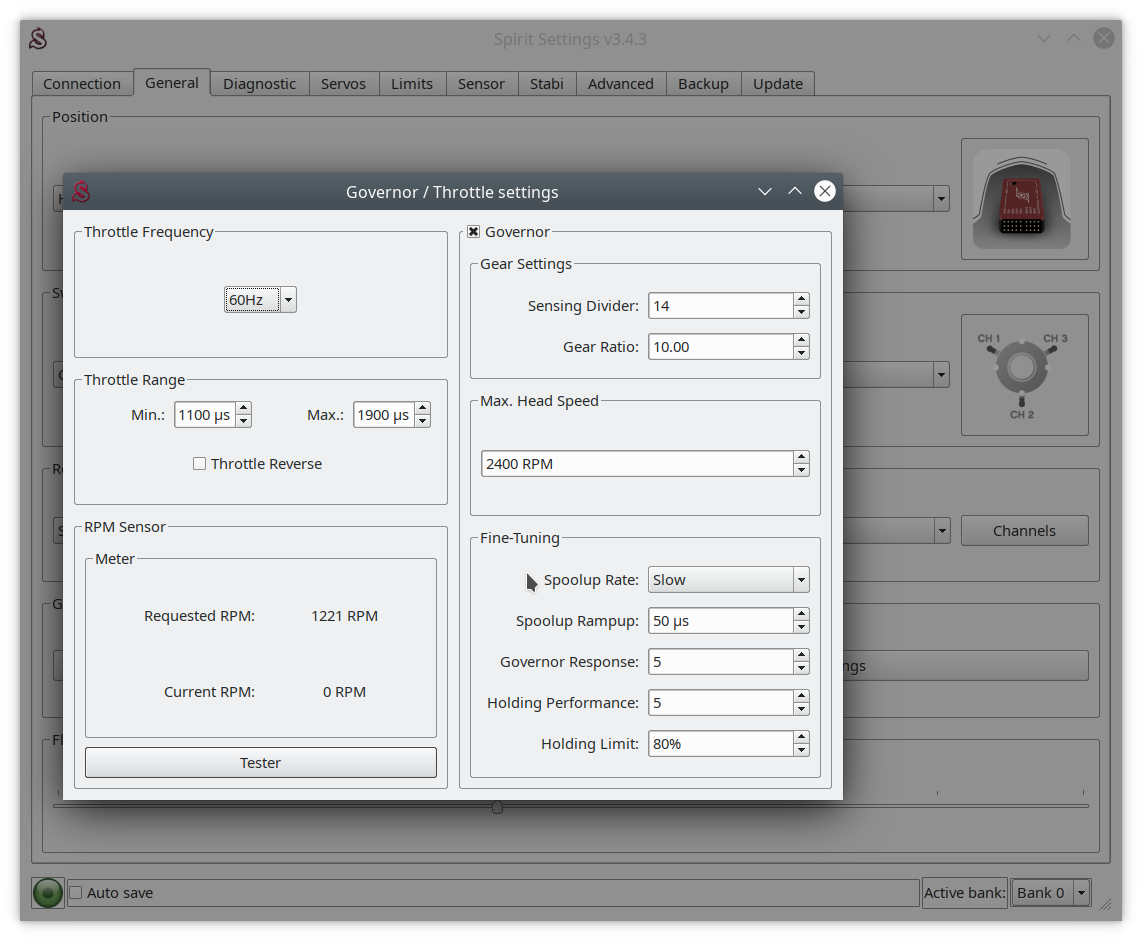

Posts: 12932
Ah, this was not clear previously.
Parameter is shared between these windows. You can set the value in Governor menu too.
If the problem was only in the Telemetry window, then please download and install the Spirit Settings 3.4.3 software once again.
I hope all will be fine.

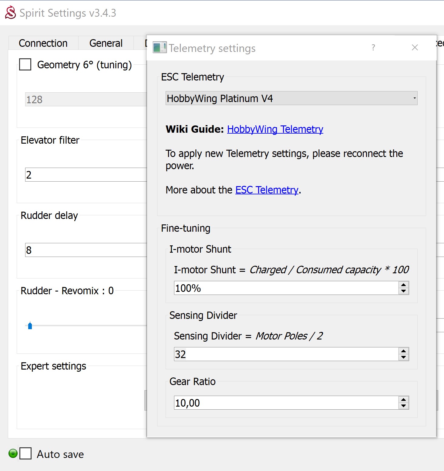

Hi Thomas,
it works now in Telemetry at 21 for Pole/2
I had 3.4.3 downloaded on 2 computers, i did as you said and dowloaded again and it worked. I checked my other computer and it was still blocked at 14, after download it's resolved on this one as well.
Do you have a explanation why the first 3.4.3 download did not work ? Did you change something ? I would like to understand for future changes.
Thanks !

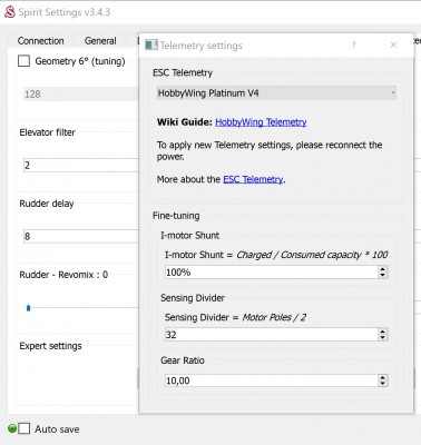

Posts: 637
I think there was something changed afterwards...
Matthias
