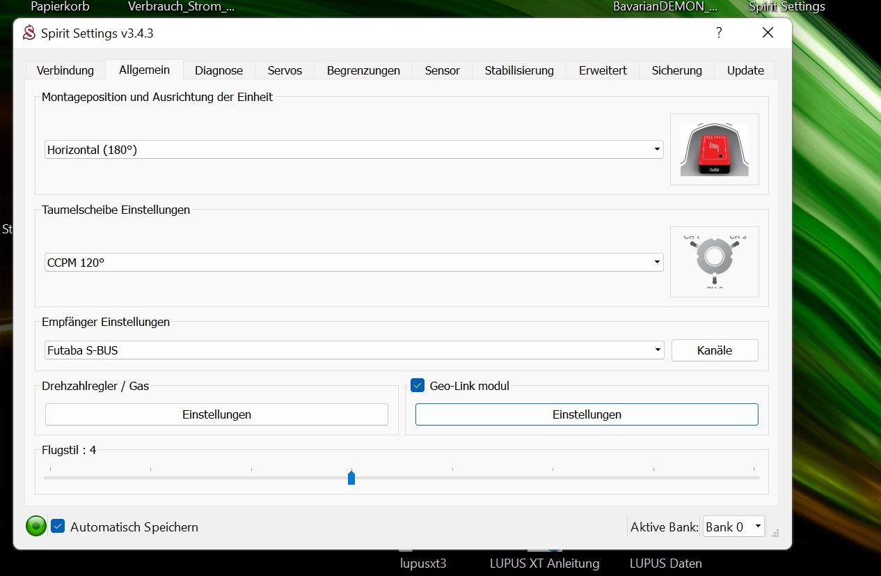

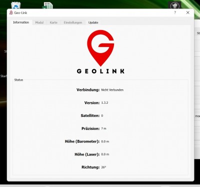

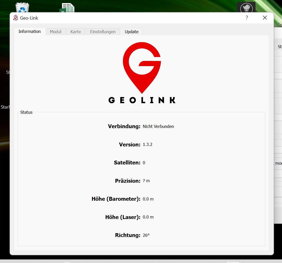

The pictures show the problem.
Geolink and Spirit GT have been updated.
How can you help me?

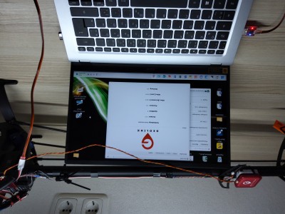

When Geolink has a view of the sky, the blue led will be on.
Then the geolink will also connect.
When I am in the room (no view of the sky), after a few seconds the led lights up blue, green, white...
See video.
When I restart the software, the connection with the Geolink is not possible.

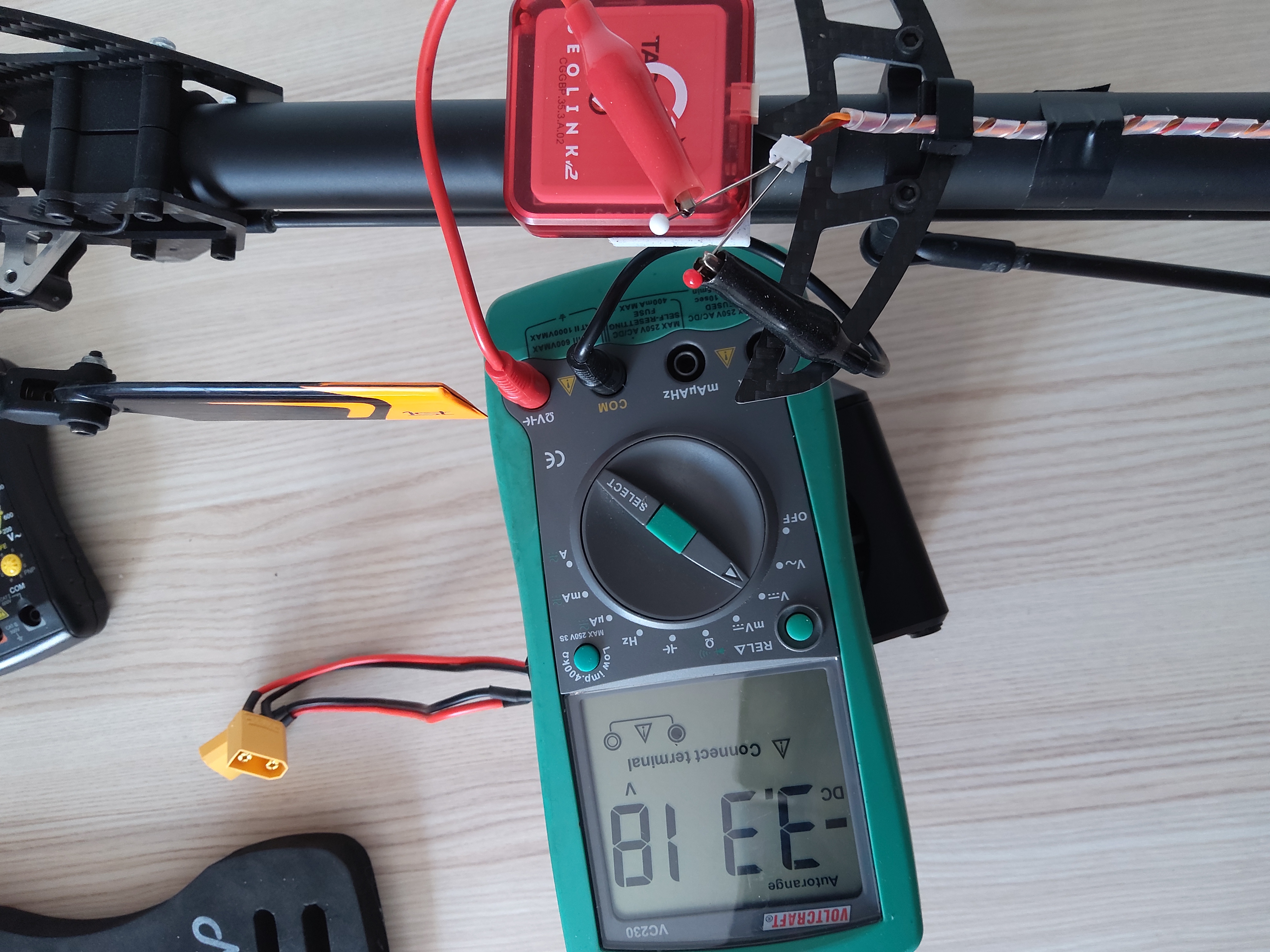

thank you for the videos.
It seems little bit unusual that the LED lights are so bright.
Maybe it is only due to a video but normally they should be around 3 times less bright.
If it is really that bright it seems that GeoLink is fed with a BEC voltage instead of 3.3V that normally comes from the JST connector.
Do you think you can verify there is 3.3V between red and brown wires at the JST connector?
If there is really higher voltage then this can permanently damage the GeoLink itself and will work very unstable.
In theory the issue could develop when something is plugged incorrectly at the JST port. For example telemetry cable that will carry + from the BEC. This can either damage the internal parts of the Spirit units or at least increase the voltage. My question is - was there anytime before connected anything else than GeoLink or a telemetry with cable that was not original (handmade)?
If voltage will be 3.3V then the issue will be rather only in firmware and this specific moduly. This can be resolved quickly I hope.
