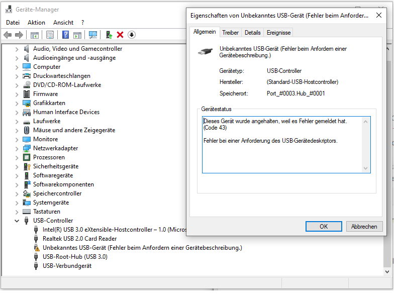

here is the windows dialog from the device manager
Posts: 13045
Please try to use other USB port if possible.
Or maybe there is some USB extension or adapter. It should work out of the box in the same way as any USB flash drive.

I tried other USB ports, with the same reaction.
I tried several USB cables.
Can i check the SD Card with the sender?
