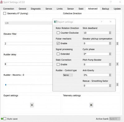

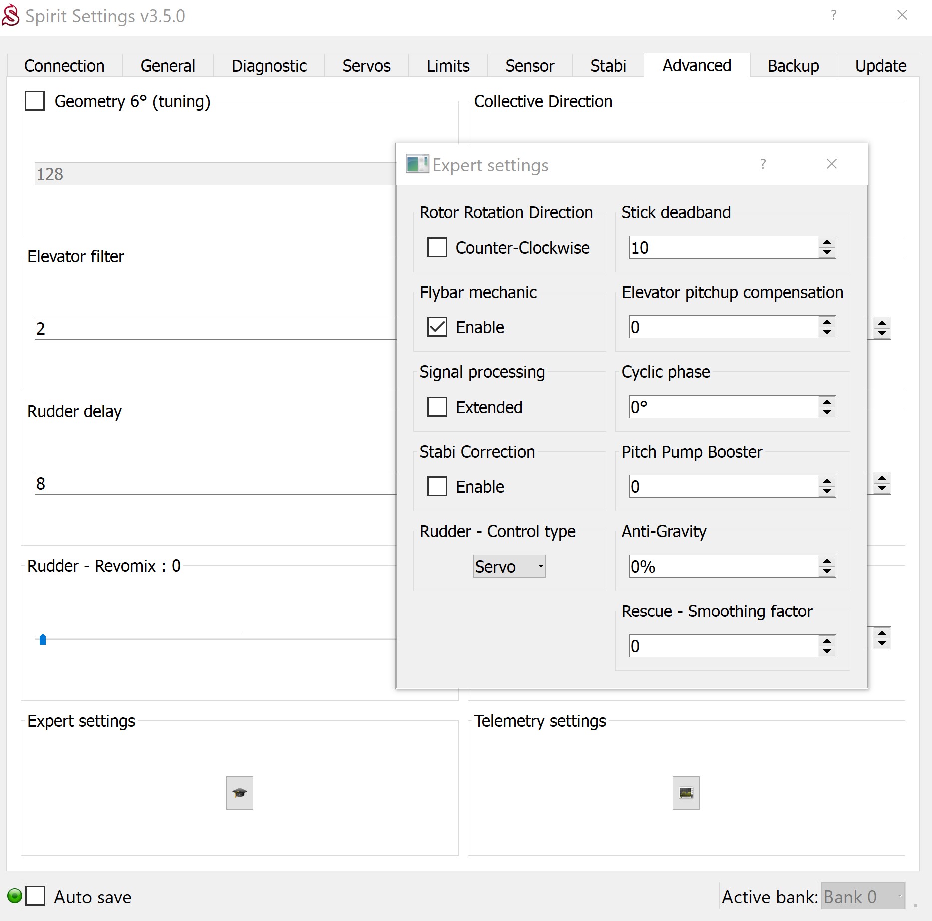

Go to Advanced tab > Expert settings > check Flybar Mechanic.
I believe this is what you are searching for, but I don't know if this can be set up for only one bank and not global.
Posts: 643
I don't believe that you can change it by bank - this setting can be done only globaly under advanced/expert settings...look at this:
I think the headgain is also part of this setting too and can not be turned off -
Maybe some other user or the developer can say more about this -

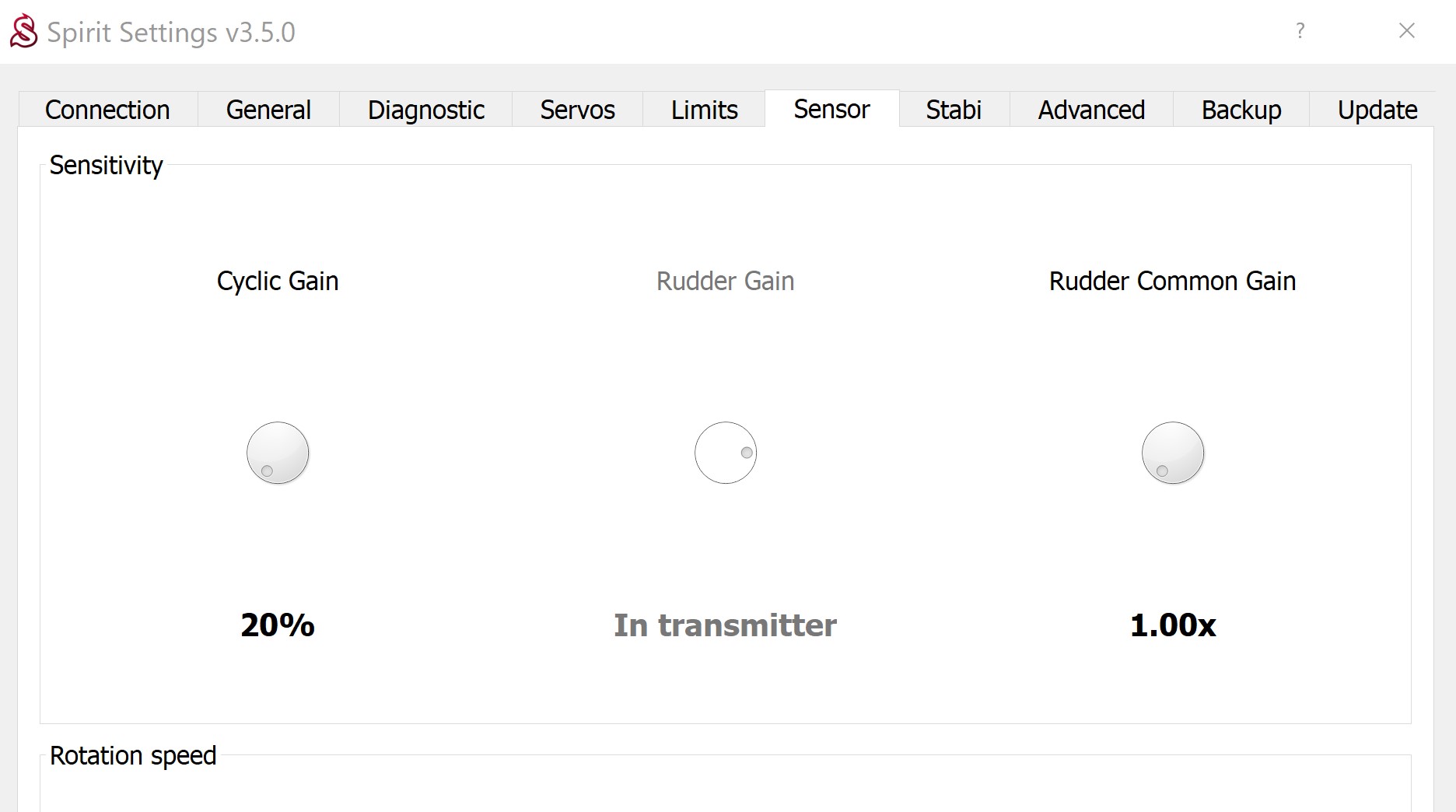

Posts: 643
If you go in Spirit Settings your headgain can be max. reduced to 20 % - but I think 20% of headgain is always "nothing" - you can make one bank with this value and then test or only flying around to test how it feels...
