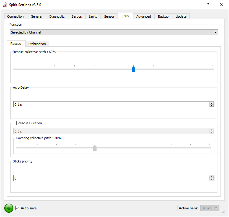

Thanks for helping me diagnose the issue.
I have check subtrim in all orientations and it is spot on, no discernable difference in the height of the blades in any orientation.
Rescue is also set up correctly, pictures below.
Thanks for the suggestions of a possible root cause, I'm open to other ideas.

Copied and pasted from the Spirit Manual...
Rescue Duration:
Once specified duration period will pass the Rescue mode will end and model will start to hover. For this purpose Hovering Collective Pitch value is used. The period is counted from time the Rescue mode was engaged. The parameter is available for both Rescue (Normal) and Rescue (Acro). Transition from Rescue to Hovering is smooth and will happen only if Rescue mode is still engaged. Collective Pitch control is returned to the pilot as soon as a pitch stick movement is recognized.
I would suspect it is as simple as ticking the box for Rescue Duration. Maybe set it to 5 sec for the bench test. In real life that might be too long tho. I use 1.5sec but its personal preference. From there adjust your hovering pitch to whatever your model hovers at out of ground effect. If unsure Suggest starting around +60%.
Also change the acro delay to 0.3 sec. 0.1 is too fast IMO
As a side note, your cyclic ring tuning should not be more that your collective pitch. You said you have the collective pitch set to +/- 10°. So you cyclic pitch should be no more or a little less than 10°, without any binding of the servos of course.

Looks like we end up having paralell conversations here and on Helifread, sorry about that.
I've tried activating Rescue Duration and increasing hovering pitch but it makes no difference. Also the manual is very specific that rescue is active as long as the switch is kept engaged. Rescue duration seems mostly to be a method to disengage rescue automatically if one is not using a spring loaded switch.

Excellent video, however I don't see any mistakes I've made. All travel directions are correct, orientation of the Spirit is correct etc.
The earlier pitctures were taken with subtrim tuning enabled. There's maybe about a degree difference around the circumference of the rotor disc measured by a digital pitch gauge. But even if there is a very small difference here, how can the Spirit be aware of that on the ground?
Changing the Rescue Collective Pitch has absolutely no impact on the behavour. If it's at 10%, 60% or 90% the results are the same, the pitch just goes to zero. Also in Altitude hold the same thing happens, the heli decents rapidly as if the pitch is zeroed. Surely there should be feedback to add collective if the barometer measures declining altitude when it's in Altitude hold?
There is no difference in behavour with Rescue Duration turned off or on either.
Is there any way of logging the state of the control loop, which mode it is in? It does not look like rescue is activated properly and i looks like the unit is stuck in some other state. I have reflashed the firmware and started from a factory reset a few times as well. What I would expect to see upon activating rescue is an amount of positive pitch goverened by the amount of Rescue Collective Pitch configured.
