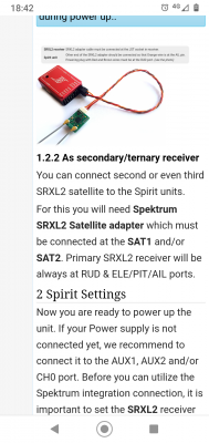

I don't know if you looked at this - there is no word of DSMX-Sats -
https://manual.spirit-system.com/index. ... trum_SRXL2

I had read that.

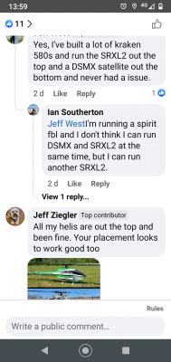

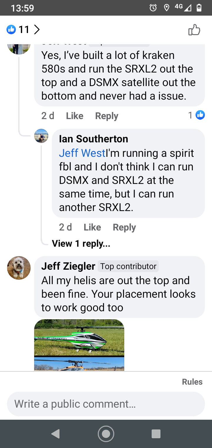

I questioned it as I get replies like shown below.
My main concern is that one SRXL2 isn't enough.
Perhaps I should just buy another!

Was this statement from Jeff West? Normally I believe his statements, but I think he is wrong - neither in the current instructions nor from Tomas is there any statement that a DSMX satellite can be installed parallel to the SLRX2. can be operated, the request was here some time ago and as I remember, Tomas said that it wouldn't work -
If a DSMX-Sat lights up, that doesn't mean that it works, it just means , it is supplied with voltage and it has been linked to the remote control, so be careful here!

It was Jeff West, but I think he may have been referring to an Icon Fbl, as this is what he tends to use on his builds.
Am I correct in thinking I can use a second SRXL2 in the second satellite port as per the spirit manual or will I loose telemetry?

Unfortunately old DSMX satellites will not work with Spirit units together with SRXL2 that are communicating at a different protocol.
For running multiple SRXL2 receivers/satellites we developed binding process that can be triggered directly from the Spirit Settings software.
This will bind all receivers properly with only one to send telemetry data. So issues with corrupted telemetry will be resolved by this.
