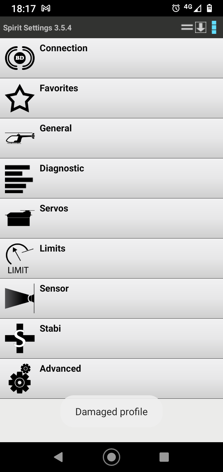

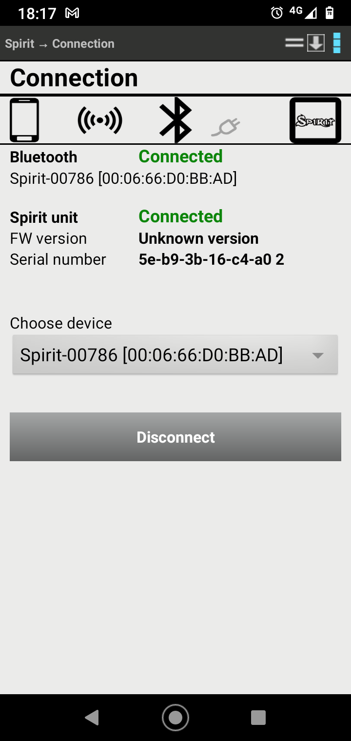

I haven't used my bluetooth module for a while, but I have a newly set up heli and thought I'd check the bluetooth out in case I need it at the field.
I can connect and look at a few menus (but never the general tab) but get the following errors, then it drops the connection.
'Damaged profile' and 'firmware version unknown'.
Is my Bluetooth unit faulty, or does it not work with the latest software?

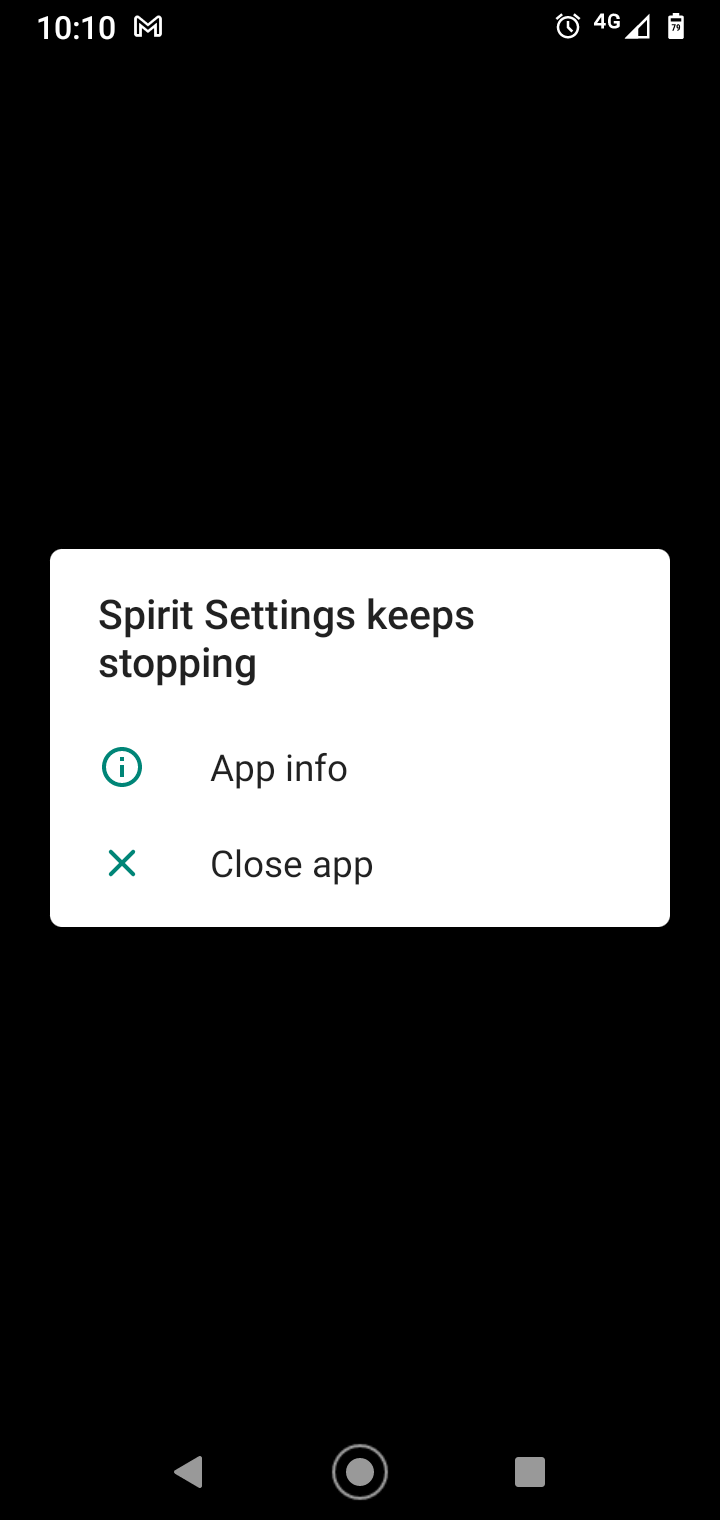

Tested it out on one of my helis

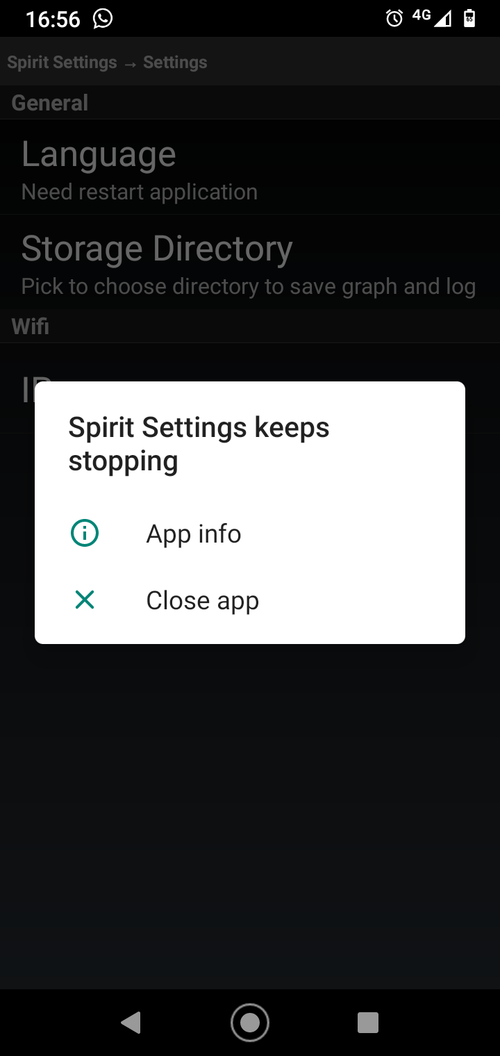

Everything seem to work fine except when I go into diagnostics. I try to save a log but get the error below.
Posts: 13045
Please make sure to set directory in the App settings for saving the logs first.

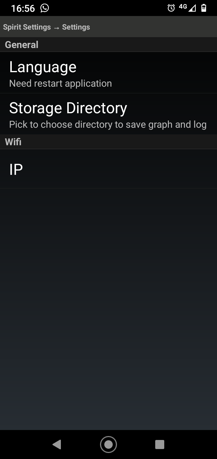

How do I do that?
I've selected settings, then storage directory and get an error.

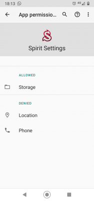

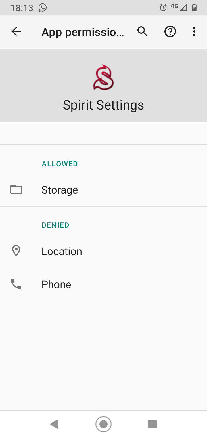

ianboom
Posts: 58
Joined: Tue 28. Jun 2016 16:55:07

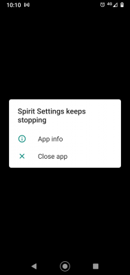

Hi.
Still no luck.
If I go straight into settings and select storage directory, it comes up with the same error above.
If I connect to the spirit unit and then go into settings it reverts back to the main menu page.
If I go into diagnostic then log viewer, it says first select a directory and when I select the storage directory it either reverts back to the main menu page or comes up with the error above again. With either result, it disconnects from the spirit unit!

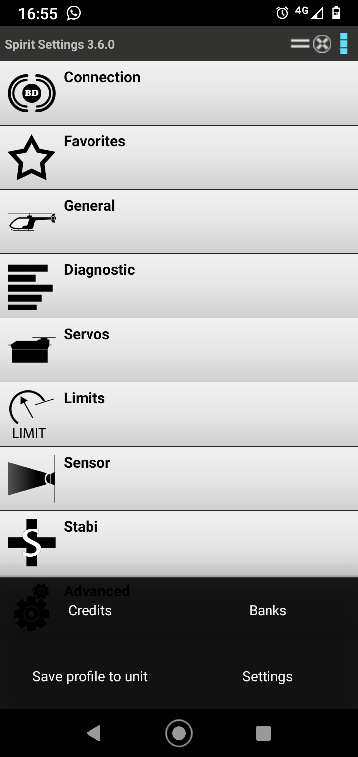

What is the end of the tab 'save settings to u..' on the settings tab?
Posts: 13045
Save Settings to u... mean Save Settings to Spirit unit. This will save settings to the unit in the same way as with PC software.
