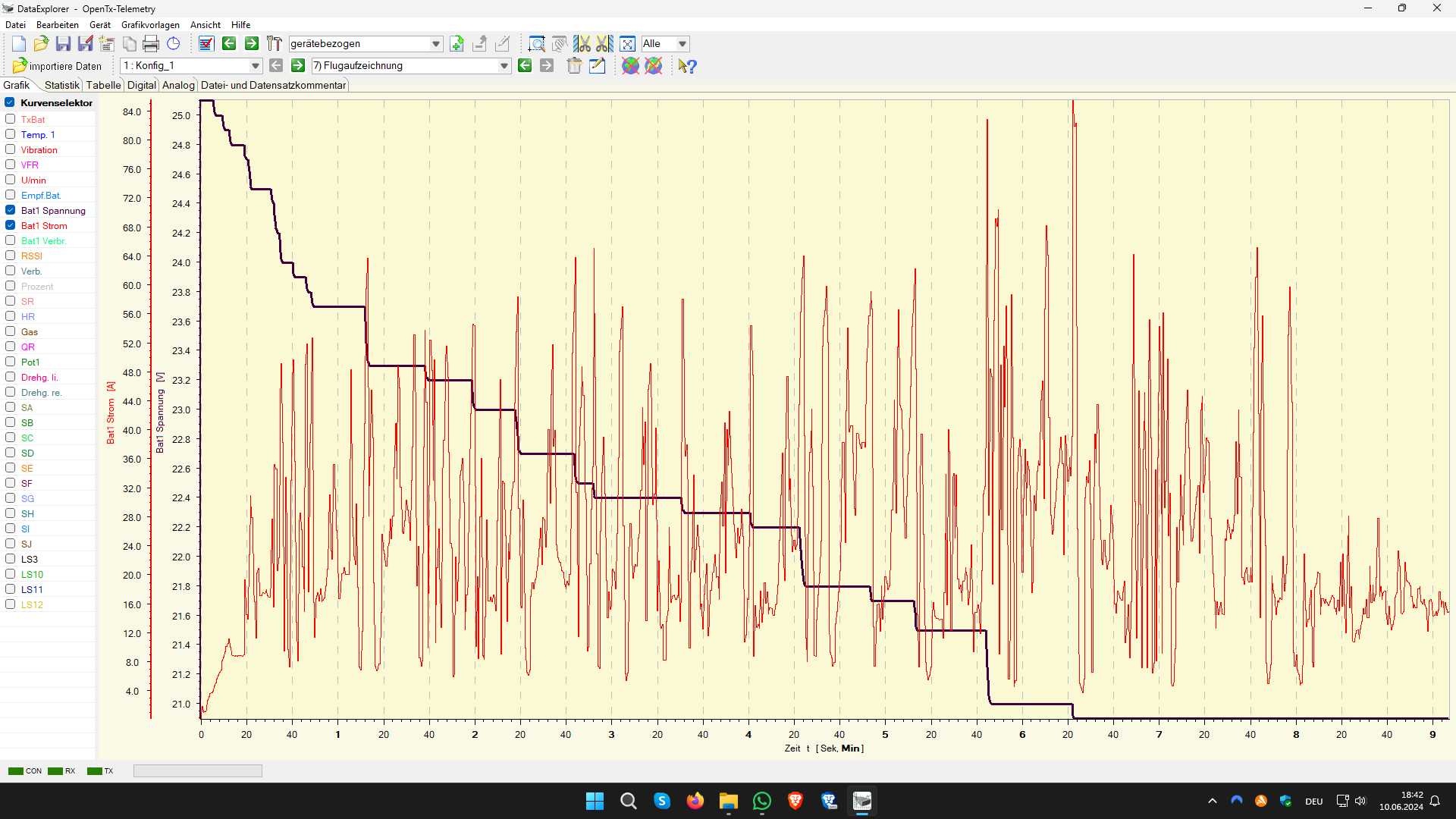

Hardware:
Spirit 2 connected to Frsky Archer RS via F-Bus (+ and - connected to RUD and inverted S-Port to AIL)
Unisense connected to Spirit. (+ and - connected to free receiver channel and signal on left pin of SAT1)
Telemetry data is transmitted and ETHOS integration works.
but there are 2 problems:
ESC voltage: freezes after some time at 20.9V. (in several flights always at the same value)
ESC consumption: The value rises too quickly at the beginning, then becomes slower and slower. (for comparison: the blue curve is the calculated consumption via current sensor)
