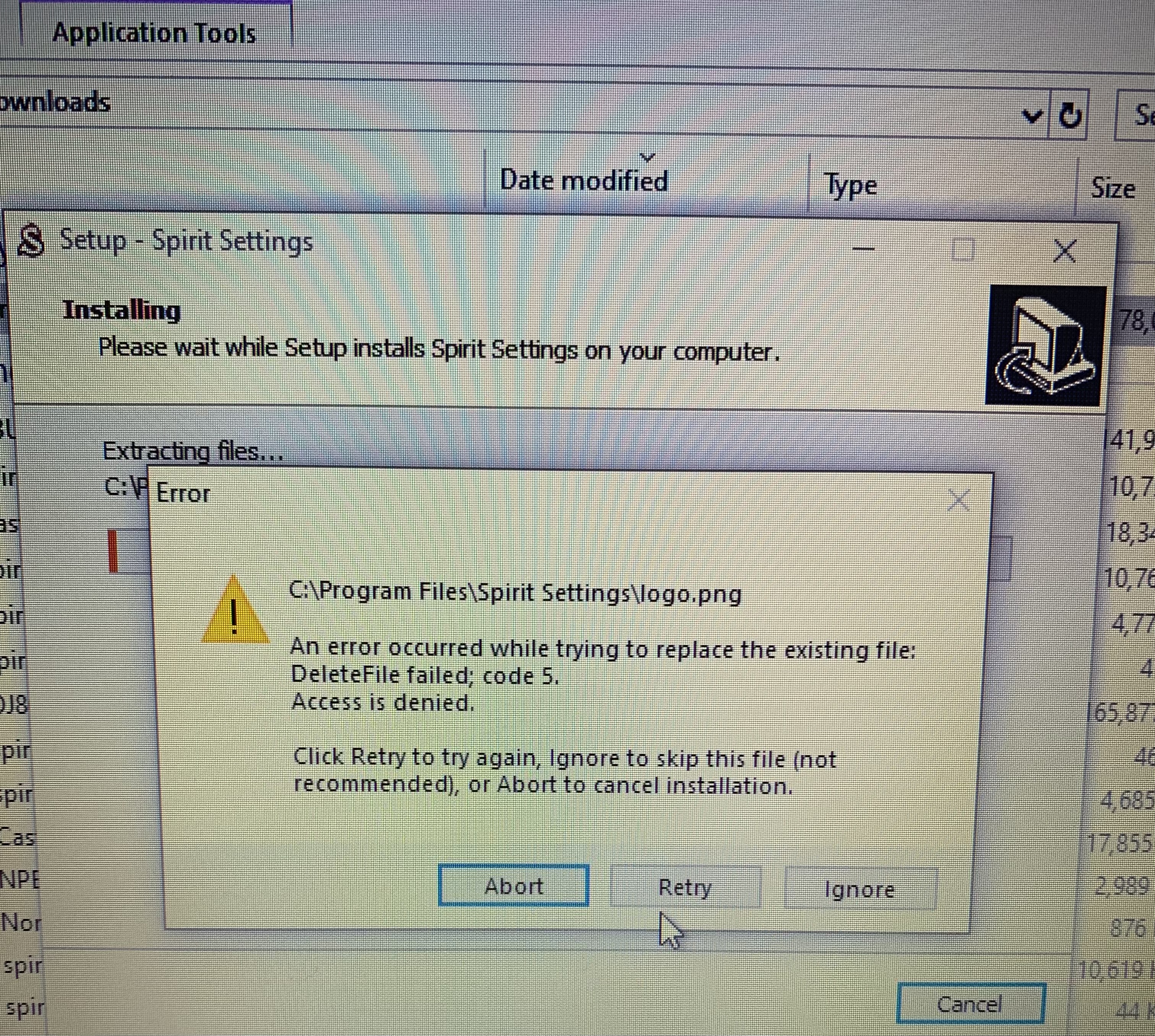

Can’t install settings software 3.7.1 because I get the following error:

I uninstalled settings software version 3.7.0, then, installed v3.7.1 without issues.
I always installed new versions over the old ones; not anymore.
David
Posts: 13044
This error should happen if old software was still running or parts of the files were opened. For this reason new version was unable to replace files for new.

ZeXx86 wrote:This error should happen if old software was still running or parts of the files were opened. For this reason new version was unable to replace files for new.
Is it ok to install new version over the old one?
Posts: 13044
