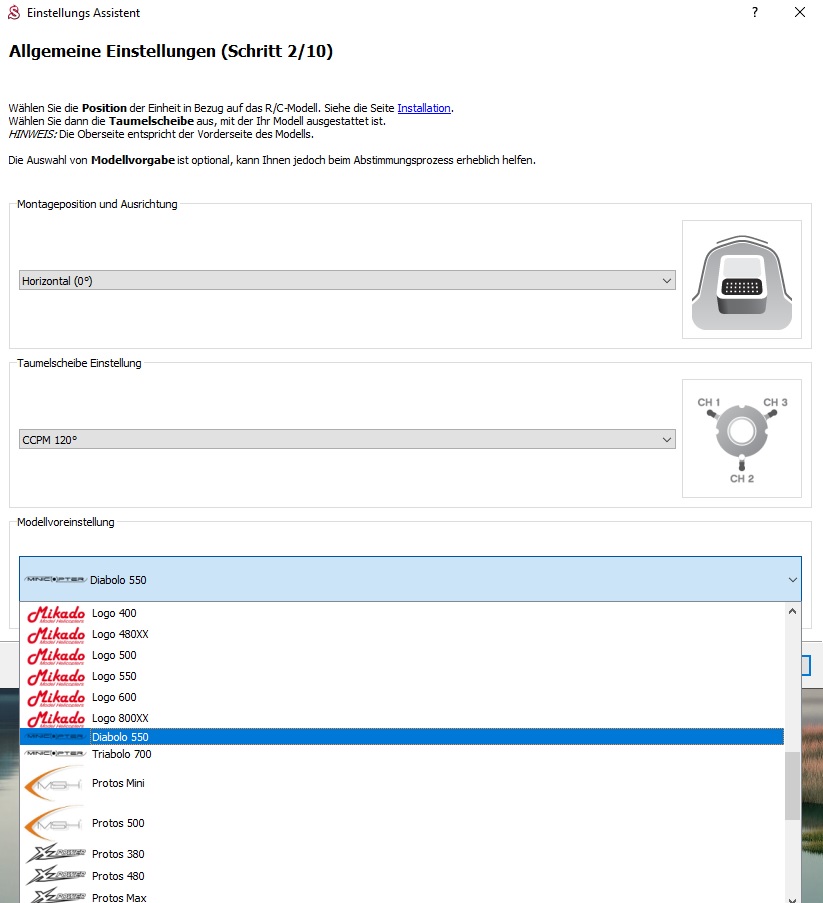

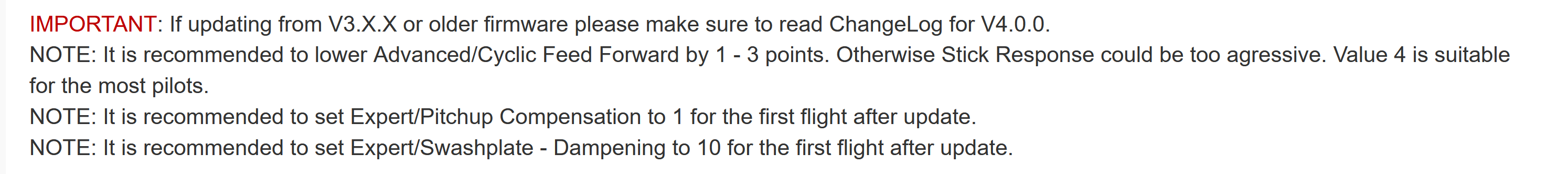

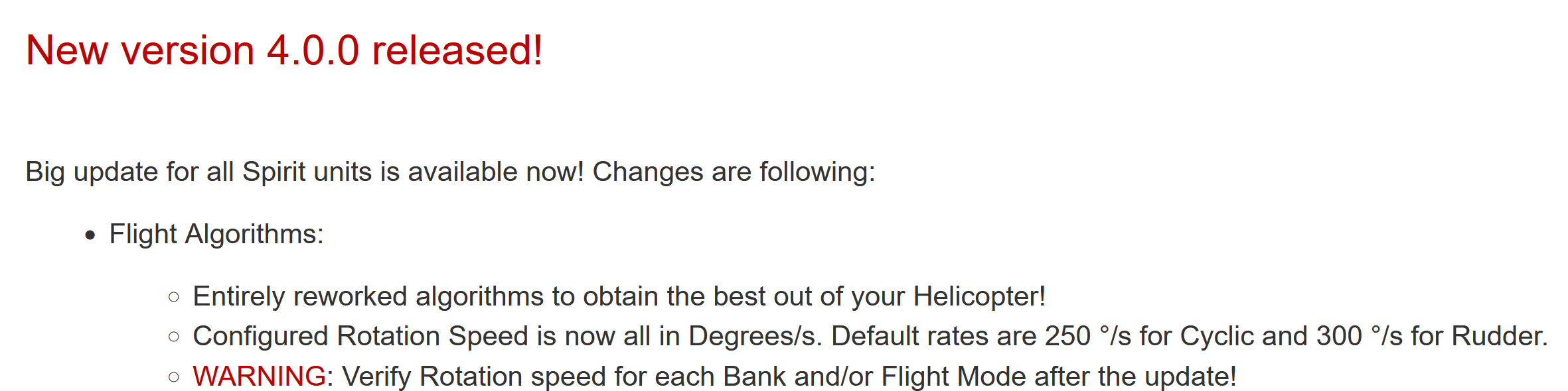

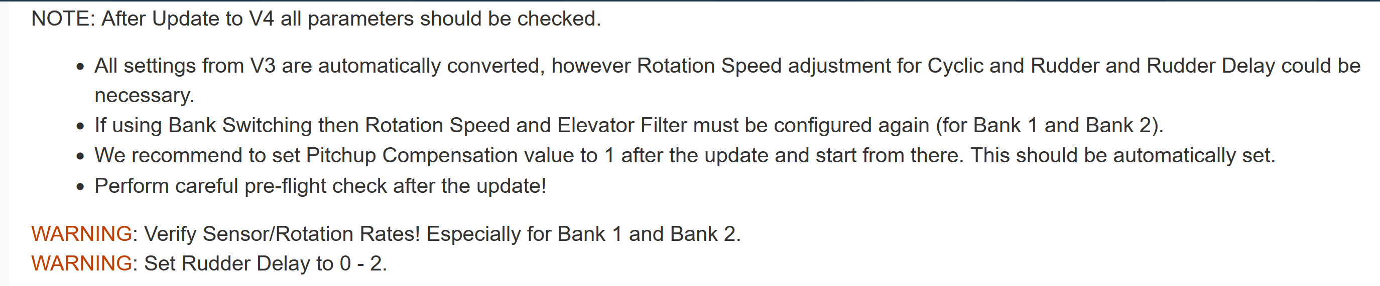

Posts: 642
Hello Tomas,
thanks for your answer !
That means no special settings as stated in the udates before rudder delay at first setted to "0" ?
The delay can be setted as described fast servo-->analogservo...?

Posts: 13039
All the presets of the Setup Wizard were updated accordingly with Rudder Delay some time ago.
On the other hand if you update from previous versions, all recommendations that are in the ChangeLogs should be done.
