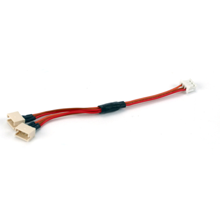

Posts: 12960
You can buy for example Align Sensor and Y-cable so you can power sensor from the Spektrum connector.
Check my attachment, please.

Can I run two spektrum satellites and the governor? What ports would all 3 go into?
Thanks Larry
Posts: 12960
This Y-harness can be connected to the native satellite connector directly to the unit. Here you will connect one satellite and governor (only 2 leads for powering it). Signal wire from the sensor should go to the PIT pin in the unit.
Second satellite should be connected to the RUD port in the unit via adapter that can be bought in our eshop.
