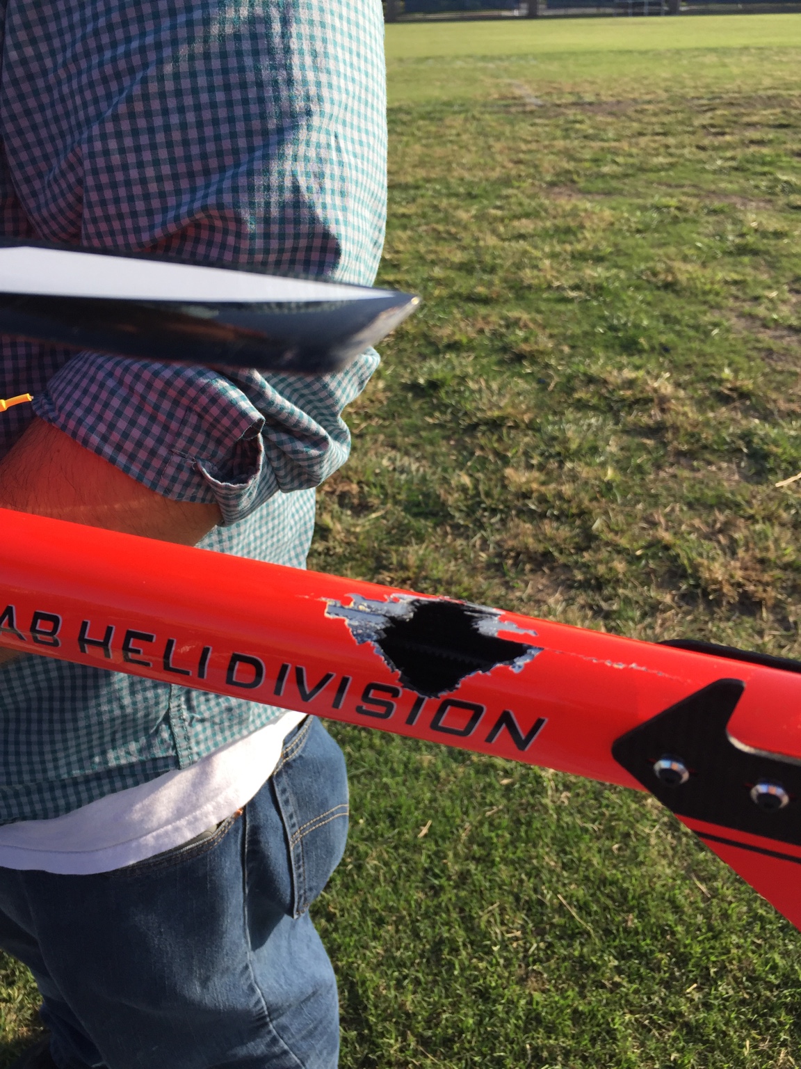

Boomstrike problem
The bailout flip is using the max pitch & elevator/roll settings. The manual says to always set these as large as possible. Unfortunately on some helis this can be way too large, like 25 degrees pitch or more. The flip will be very violent with such setting and there is a clear risk for boom strike. Reduce the max setting down to something like 15-20 degrees and then go from there to determine a flip rate that is comfortable yet saves the heli.
This may be a good opportunity to ask for a setting to limit the bailout flip rate
Yup, it's been asked for several times already. I'm assuming that it's in the works and will be released shortly.Hakan wrote:This may be a good opportunity to ask for a setting to limit the bailout flip rate
