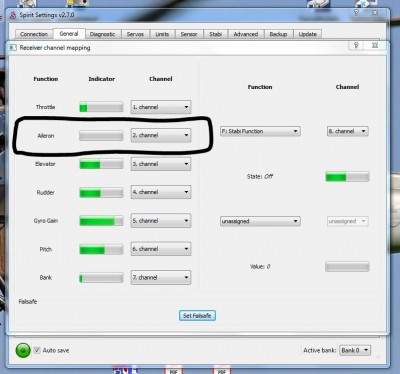

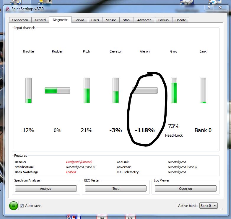

It is difficult the breakdown is random.
I tried many times as you ask, leaving the 3 main plugged in, apparently the fault is gone.
By plugging everything in, it happens 1 time in 10 that the fault appears.
On the displays when there is a breakdown, the aileron servo is problematic, see screen photos.
I flew like that no worries once properly initialized.
Thank you for your participation.
