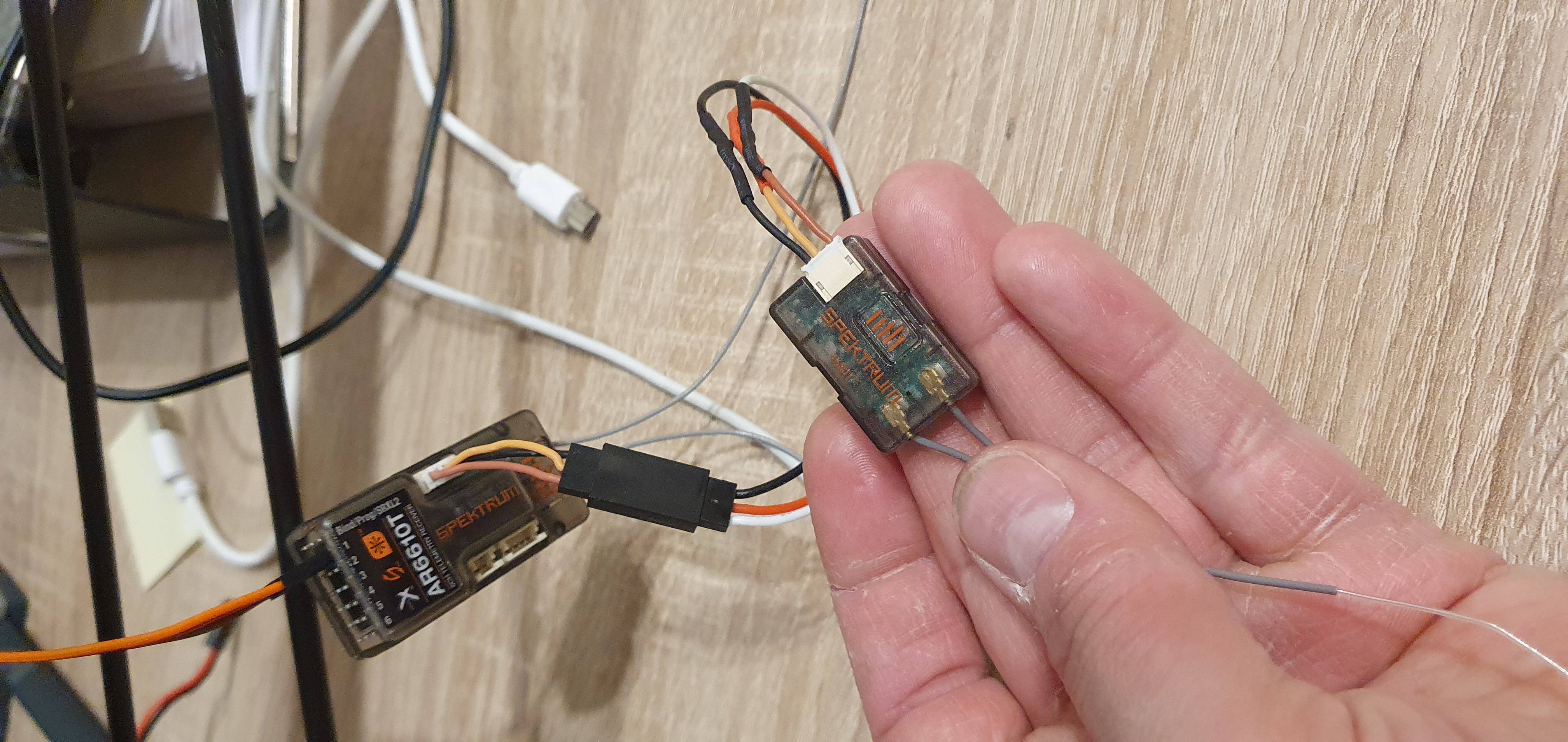

Hello, everyone,
I'm trying to get the AR6610T + 4651T to work. But it doesn't work. Both receivers have the latest firmware. I have connected the AR6610T to channel 1 according to various forums and the 4651T to the SRXL2 connector on the AR6610T. The heli does not initialize. It only works when I connect the AR6610T alone. Then via the Bind/DAt/SRXL2 port. What do I have to do to initialize the heli when the FBL is connected to channel 1 of the AR6610T? Many thanks for your help

I pressed the button on the AR6610T. then both receivers flashed and I was able to bind successfully. nevertheless the heli does not initialize. I'll test again if it makes a difference when I press the button on the 4651T.

in the FBL, the SRXL2 output is correct, isn't it? so even if it is connected to channel 1?

I have the latest firmware installed on the transmitter and both receivers. All products are registered with Spektrum. I soldered the original cable. The receivers both go into bind mode and it binds successfully. But the heli doesn't respond. I noticed that the 4651T flashes earlier than the AR6610T. If that means anything? AR6610T only works on the BIND/DAT/SRXL2 port when I connect it alone. Binding works without problems on port 1, but the FBL does not recognize any control inputs.
Spirit 2 Software is 3.3.3
Here is a Video : https://youtu.be/lX6PCOmUaZs
What else can I do ?

Hello, I have set SRXL2 in the Spirit. In SRXL2 mode it initializes correctly. I don't get as far as adjusting the gas in the connection to channel 1. Nothing moves in the diagnostics menu. just by connecting to Bind / dat /srxl 2

Hi, but the binding also works with the Spirit without any problems. in my video both receivers are bound. They shine permanently. I can still try to bind the receiver with a battery. Binding isn't really a problem. binding works. but the helicopter does not initialize despite the bound receiver. That's my problem. many thanks for the help !
Update :
I have now tied with the battery, but the Spirit does not respond to any inputs. later I show the settings in the Spirit. I don't think that's wrong, since it works with the SRXL2 port alone.
