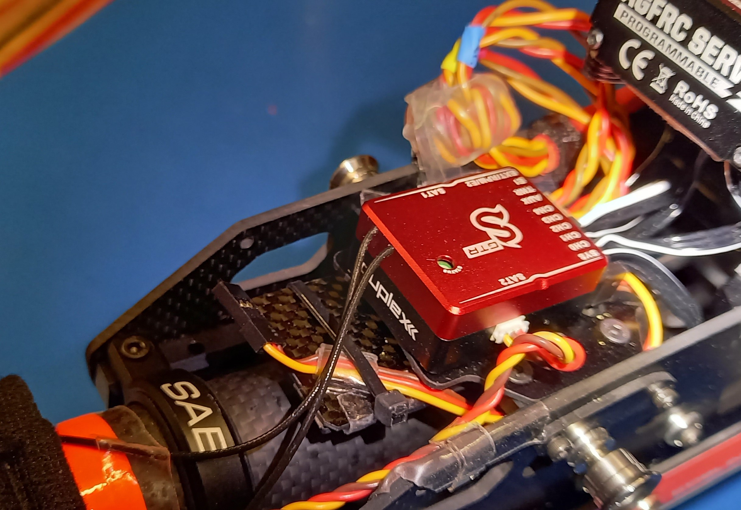

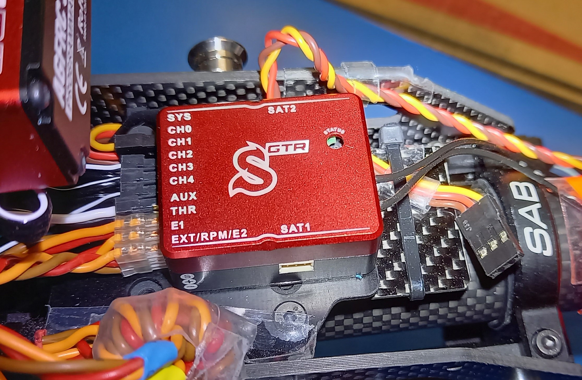

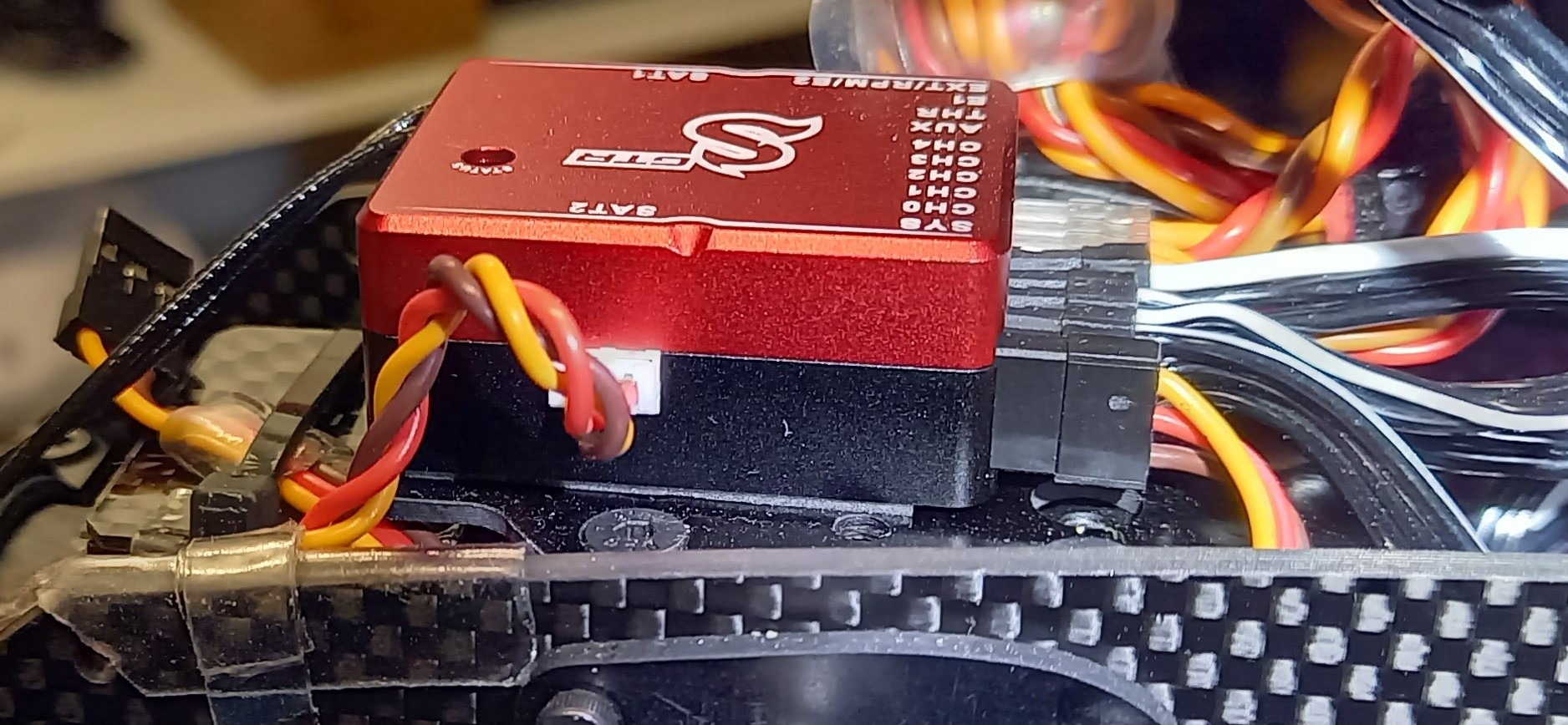

p-51d
Posts: 12988
can you confirm that Rudder Delay was configured to 0? This is very important step.
Is supplied double sided tape used? (one layer)
Is the unit mounting rigid so that unit can't bounce at the model in a yaw direction?
Can you check no cable/connector is touching the unit's shell?
p-51d
Posts: 23
Joined: Thu 01. Jul 2021 11:48:21
Hi
Sorry about my late answer; - didn't receive a message from the forum website...
Yes, Ican confirm that the RUDDER DELAY is set to 0 .
Yes, there is the original double sided tape ( one layer ) used for mounting the unit ( included in the package of purchase )
The SPIRIT is mounted rgid and can't bounce in any direction...
None of the cables is touching the unit and there is some freedom from the connectors to the origin of the cables...
The rod to the tail is moving freely witout any resistance...
The heli is brandnew ( approx. 15 flights ) therefore no damage of the transmission rotor head or any other parts...
Kind Regards

Posts: 23
more pics
