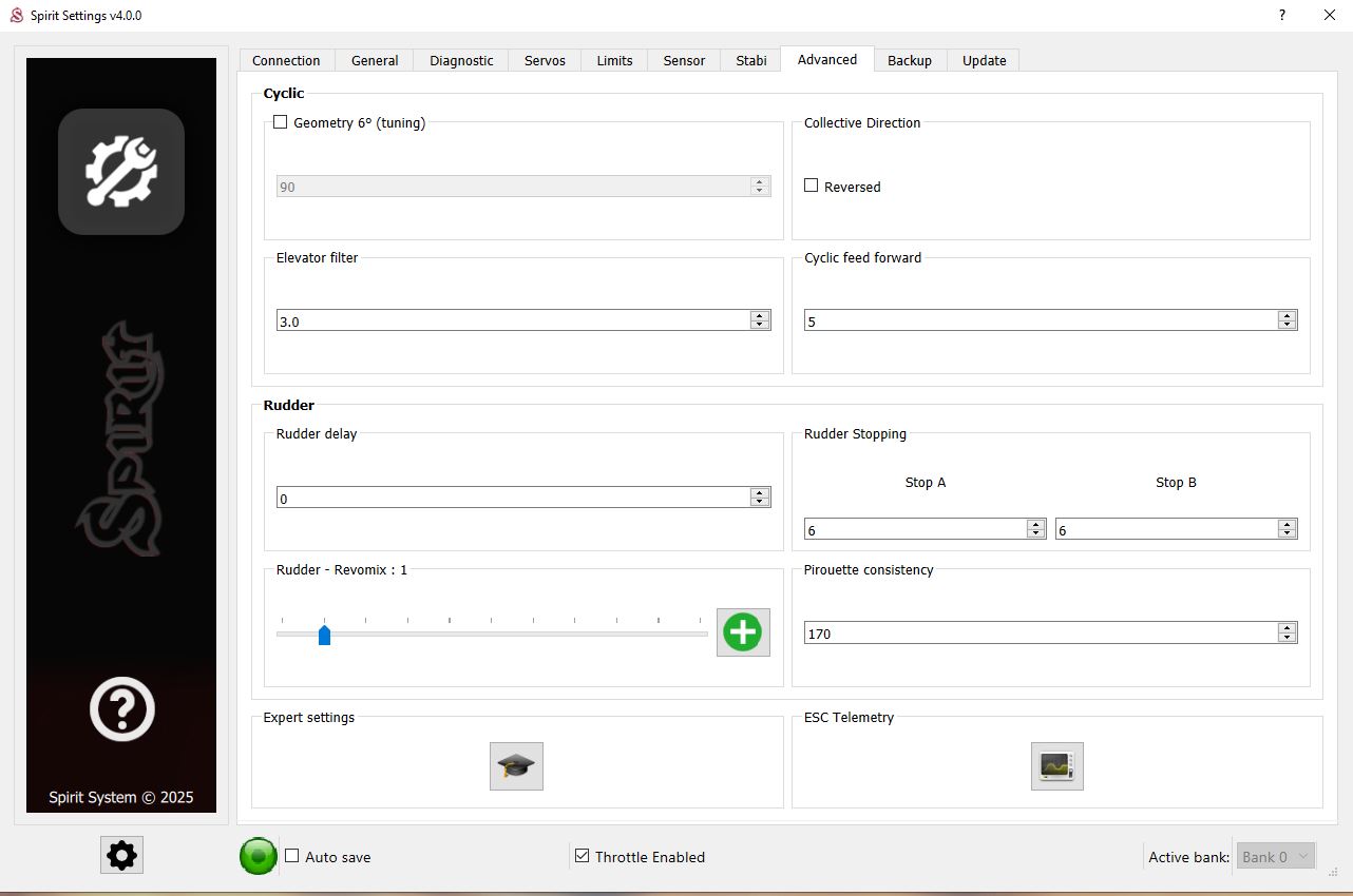

Thank you for sharing.
From the settings it seems you have not selected Goblin preset, so there are default values for small helicopters.
These parameters should change:
Advanced - Rudder Delay to: 0
Advanced - Pirouette Consistency to: 190
Advanced - Elevator Filter to 3

Hi Thomas
in the meantime the changes you wrote are stored to the FBL.
Made about 30 flights ( range 155 up to 190 in steps of 5 ) ,
without any success - the tail is still wagging; the higher the
RPM's the higher the frequency of the wagging...
It seems that even decreasing the value of the gain for the tail
has no effect to the wagging. Increased and decreased the
gain til the tail didn't hold pos any more...
Sorry for the bad news, do you recommend other changes ?

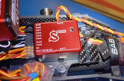

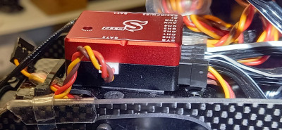

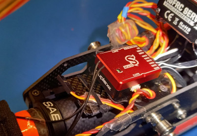

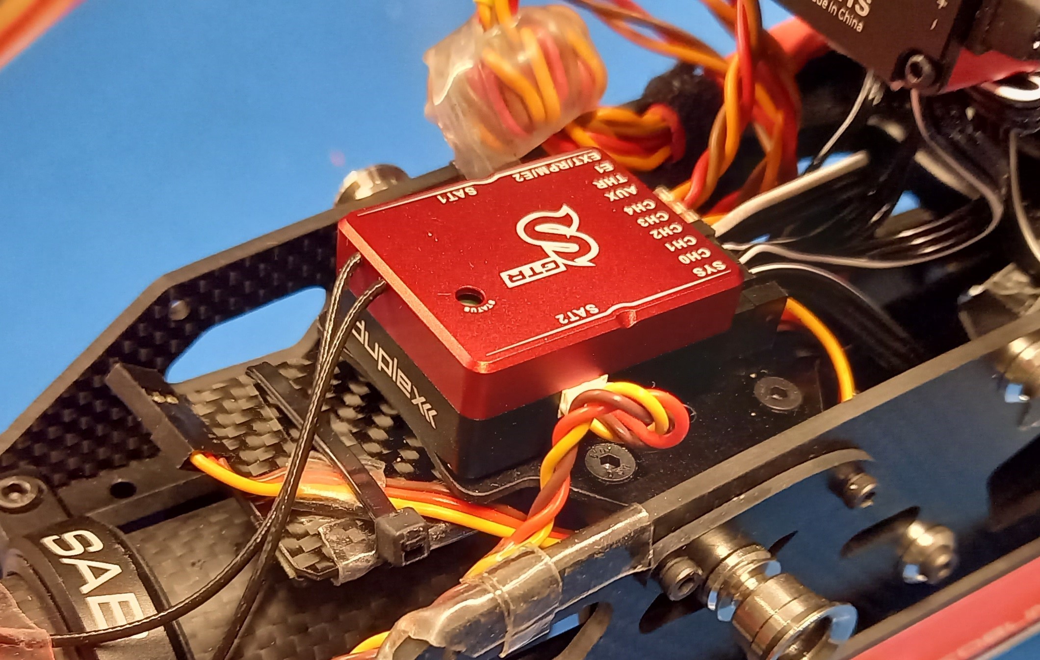

can you confirm that Rudder Delay was configured to 0? This is very important step.
Is supplied double sided tape used? (one layer)
Is the unit mounting rigid so that unit can't bounce at the model in a yaw direction?
Can you check no cable/connector is touching the unit's shell?
Yes, Ican confirm that the RUDDER DELAY is set to 0 .
Yes, there is the original double sided tape ( one layer ) used for mounting the unit ( included in the package of purchase )
The SPIRIT is mounted rgid and can't bounce in any direction...
None of the cables is touching the unit and there is some freedom from the connectors to the origin of the cables...
The rod to the tail is moving freely witout any resistance...
The heli is brandnew ( approx. 15 flights ) therefore no damage of the transmission rotor head or any other parts...
