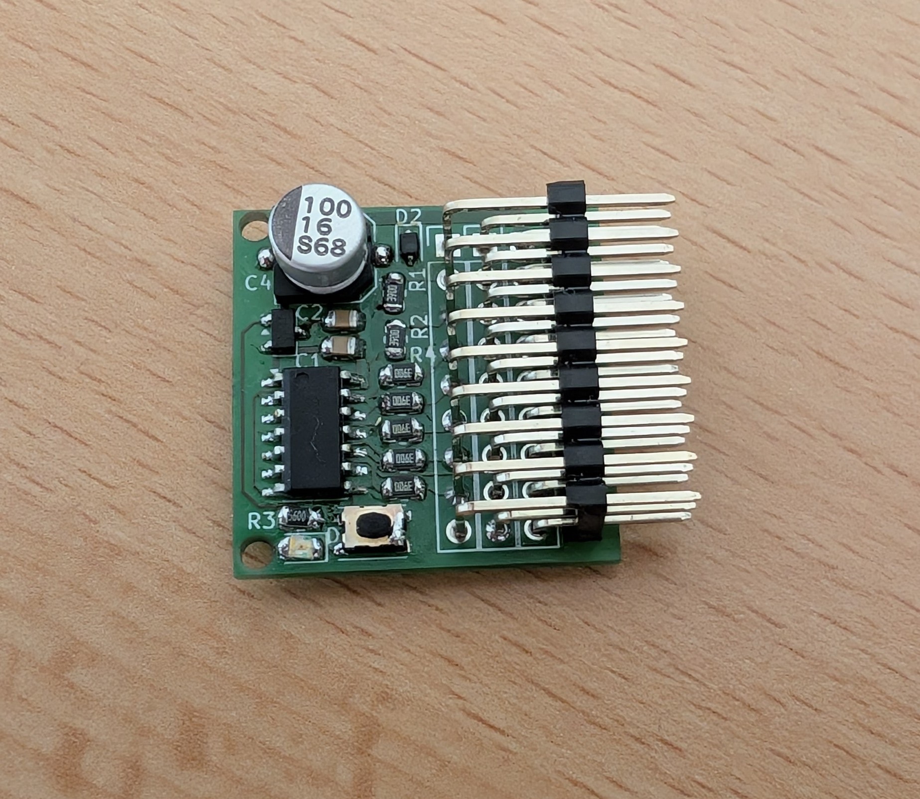

I made a servo-extender/telemetry protocol converter which is currently running for Jeti Ex Bus. It is also capable to convert telemetry protocols.
If I had a protocol specification for Spirit/W1, this would also work on a Spirit system. In case of success, I would make it open source to have a reference implementation and a handy tool to use Spirit also in scale helicopters. This is the corresponding repository for Jeti: https://github.com/Sepp62/JetiExBus
