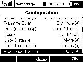

OK there is "auto" and the frequency has been changed to 100Hz for more smooth movement.

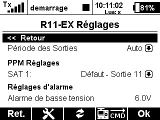

Hello, I searched everywhere I do not see where to come from. ???
100Hz settings is good.
Please verify how Output period is configured in your receiver.
Default is 17ms. How it is configured in your receiver?
Changing the value could help.
Could you also show me how General/Channels is configured please?
You can attach you 4ds file or take a screenshot.
