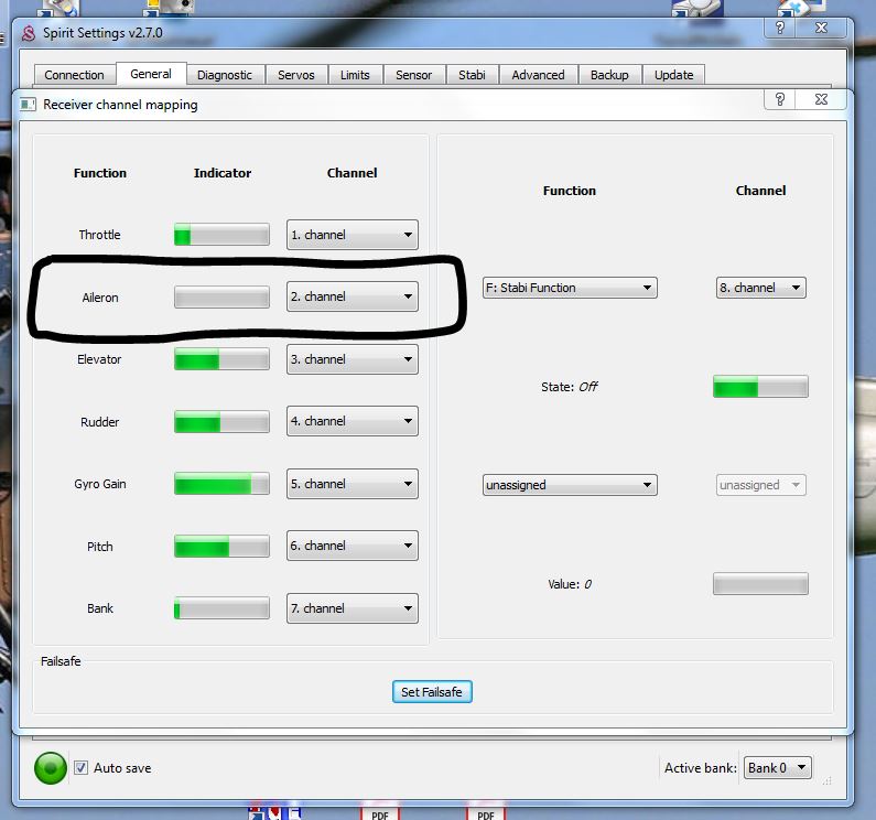

It is difficult the breakdown is random.
I tried many times as you ask, leaving the 3 main plugged in, apparently the fault is gone.
By plugging everything in, it happens 1 time in 10 that the fault appears.
On the displays when there is a breakdown, the aileron servo is problematic, see screen photos.
I flew like that no worries once properly initialized.
Thank you for your participation.
Cdlt

Hello, it still does not work, I leave like this and I fly, if the reset is not done well at the start, I stop and I start again.

Hello, yesterday day with no wind, beautiful sun, the 700 left on the side in rapid flight before, impossible to catch it, it fell very hard, by by 700 completely hs.
Why ?????
Why ?????
this is very sad. Unfortunately I dont understand why the problem is happening, it does not happen to anybody else.

Hello, with the new version 3.1.0 this problem has disappeared, it has never prevented me from flying but often I had to redo the module startup several times.

Hello Tomas, sorry for the false good news, I flew yesterday and it still looks the same, nothing has changed, I don't really see what it can be. I had other problems after the update, in flight the plateau goes down alone for 1/10 of a second from time to time, not at a standstill.

No it worked fine before update, I didn't change any component.
thestructured
- Posts: 157
- Joined: Thu 24. Dec 2015 20:13:20
I think since the problem the entire duration of this thread was with the same receiver, it may be worth trying a different one to see if the problem goes away, along with new wiring. At least then you can rule those components out.
