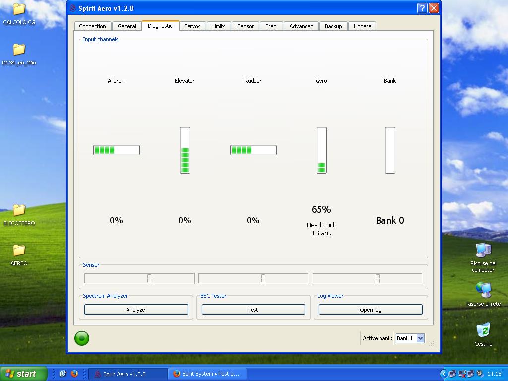

Hi I set general gain with negative value for both banks, but the situation is non changed, see screenshot.
In this situation I need the Normal+Staby not Head-look+Staby.
Is possible? Thanks
Posts: 12920
Ah, this is not possible. Otherwise stabilisation mode will not work. It would not hold required attitude.
So then Stabilisation mode will have no meaning in this case.
