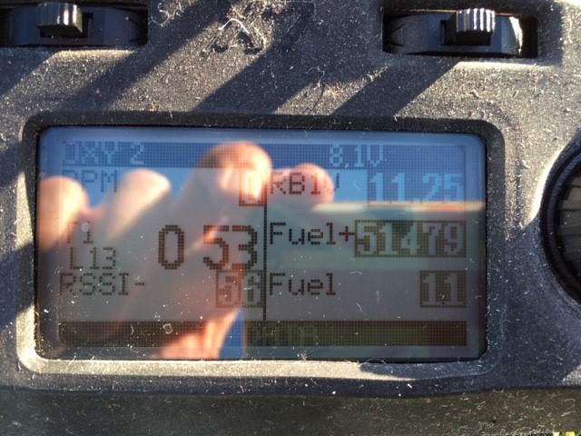

I have these also - but in my case for Fuel +, which I was using to see maximum vibes
This is with OpenTx 2.3.5, the latest V2.0.1 ACCST firmware using micro Spirit with HW integration and OpenTx integration (2.7.1 version). I foolishly changed the ACCST firmware, Changed the OpenTx firmware and added Fuel+ to my telemetry screen all on the same day so I don't know which one introduced the problem :(

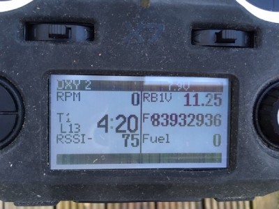

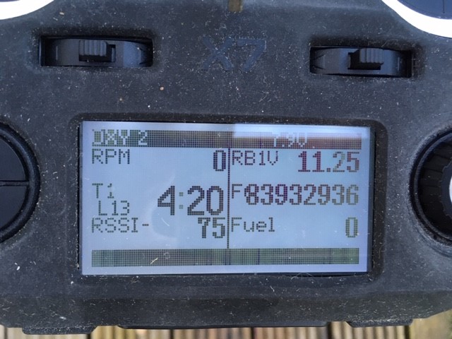

Do you think that I need to worry about my 83,932,936% vibes - bad blade tracking perhaps?? :geek: :geek:
