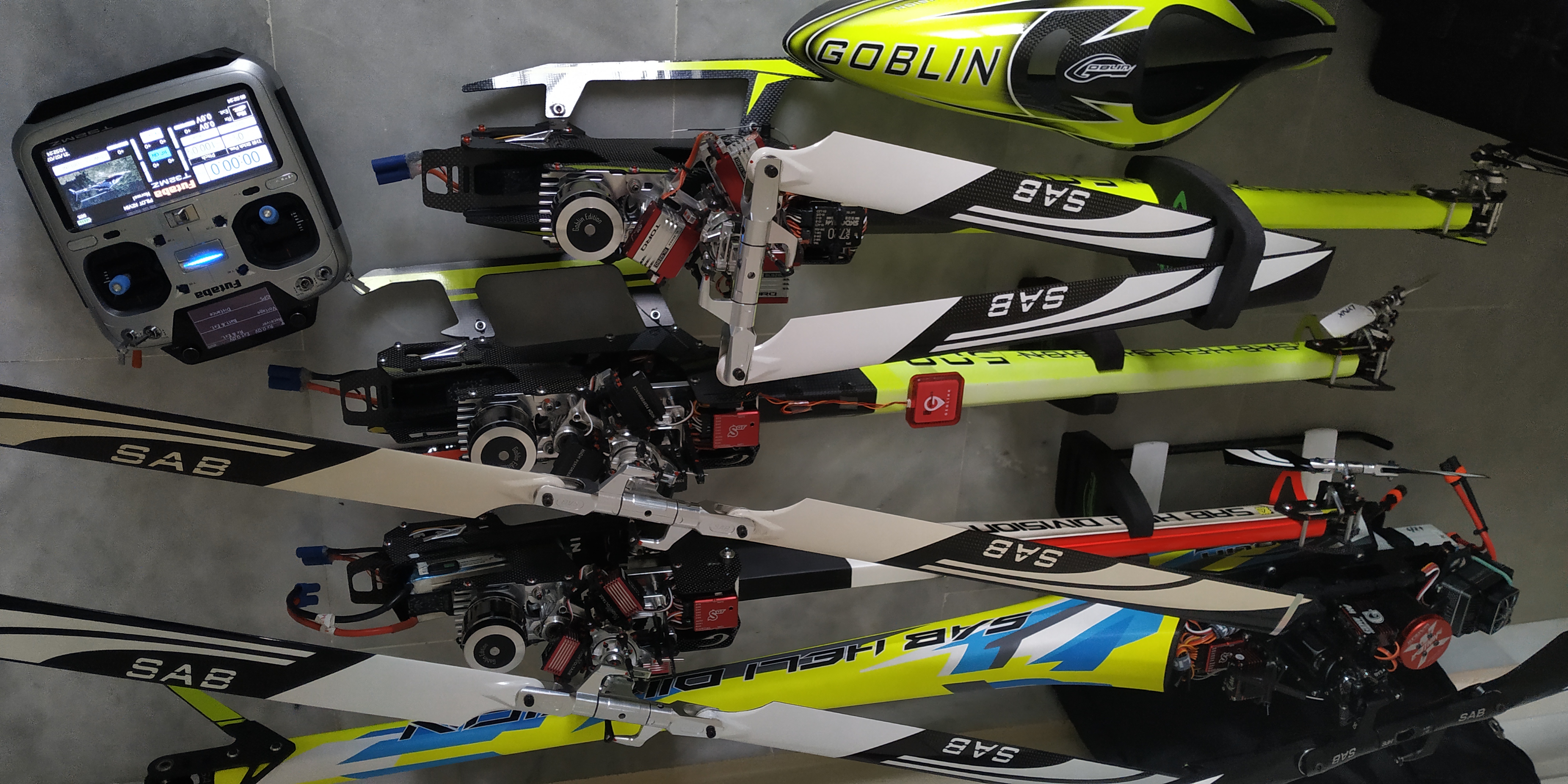

Thank's for the quick reply, here a Picture of my Heli's and a Youtube Link with one of the first Test Flight with my Kraken, also I have to say again , I like the Factory setup just out of the Box, will Try to fine tune this weekend but I think not much to do.Loetefix wrote:Please post a backup from your settings and a Picture of your Spirit Unit on the Helicopter.

Also the Kraken Test Rabbit I like it .
As you see on the picture I do not have a problem with Channel's quantity and Functions, ( from Transmitter side)
