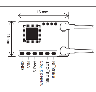

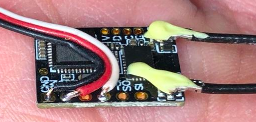

I already wired up my Archer RS to use the Inverted S.Bus/F.Port port with Brain2/Ikon2. Now I want to use the same receiver to try out the Spirit GT. Do I need to resolder to the S.Bus port?

Resolder the wire to the third pin (sbus) and flash fport FW and you are good to go

I want to use F.Port. And I believe there’s no flashing required Archer RS because you can switch protocols from the TX via ACCESS

you will need normal/stock wiring of the receiver.
