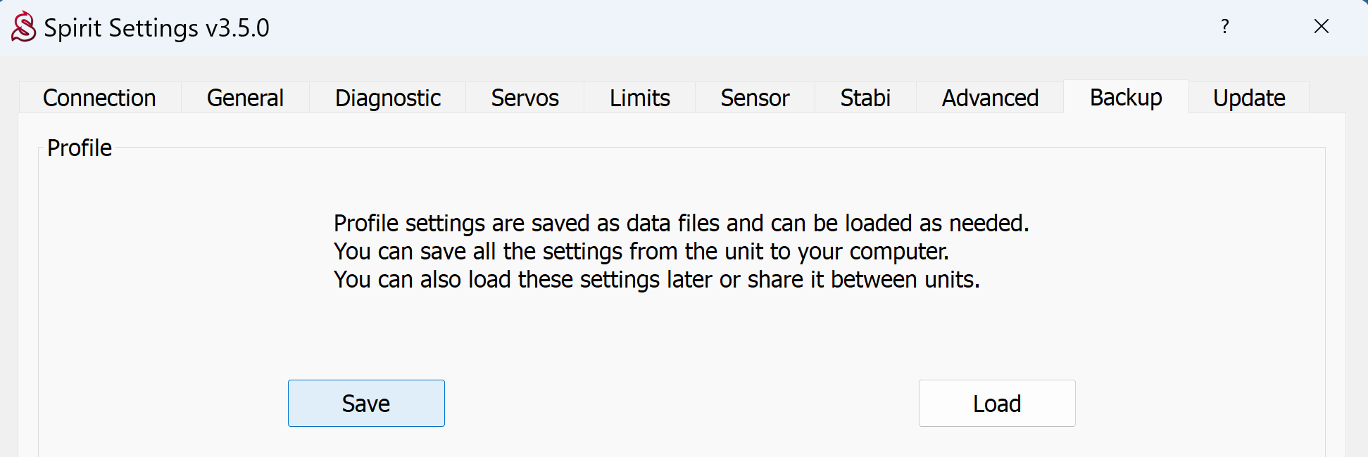

save your settingsfile out of the Spirit Settings Program as you see here:

Hello that's not rocket science, look at this:
Follow these steps:
Click on save
Enter a name
Click on save
Now in this folder is the file, here in my example C:\Program Files (x86)\Spirit Settings
That's all !
